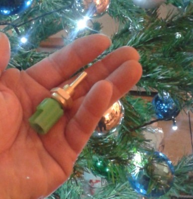

The sender part number is AJ8 10031. My replacement has been ordered from British Parts and came for around £17 including P&P. Before ordering a sender though, be aware that thread size is important. Two sizes would appear to be available. Mine had a 12 x 1.25 thread but another I saw at a Main Dealer had a thread that appeared to be around 18mm. Obviously you need to get the right one for your car.
A good bit of advice here. BUY ONLY Jaguar original parts for these critical parts of your car. Namely temperature sender/sensors and thermostats. Several members including myself have bought cheap items which have frequently failed prematurely or not been up to the job even when brand new.

As a get me around measure, I installed a new but aftermarket sensor I had in stock whilst waiting for a genuine part to be sent down from British Parts. This has not been that successful in that the temperature gauge now fluctuates between stone cold and full hot! This really teases the engine management ECU which will within a few minutes switch on the restricted performance message, the orange lamp above it and the engine check light. a high idle can also become present. Clearing fault code off with my iCarsoft 930i helps but the orange light will often reappear. The temperature gauge will show cold but switching the engine off then on again will sometimes produce a full hot indication.

Almost definite now is that the Intermotor aftermarket sender is a duffer. Full red gauge readings. So the old unit put back in the car and better results obtained. However, this sender has done 80k miles and could have a weakness from use. What I now need is the new sensor which should arrive shortly. I can then do resistance readings for all three units in hot water at increasing temperatures and see how their graphs pan out as individual units.

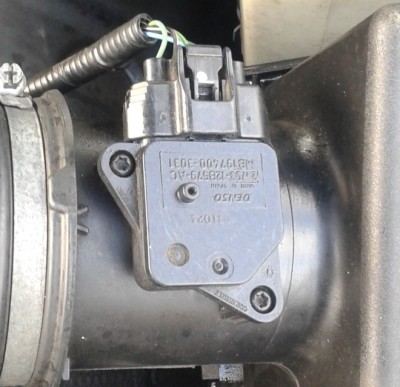

My deliberations lead me to consider what I had not yet cleaned up or inspected since I took ownership of the car in September 2015. The MAF sensor screamed out for cleaning and that as some of us know, does have an influence on fuel/air mixture control. Something I had meant to do but had not yet done.

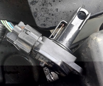

Here is the hot wire before cleaning. This type of unit will be found on many modern fuel injected cars. The MASS AIR FLOW sensor does just that. It senses the airflow mass through the induction pipe immediately after the air filter. It is well known that crud can build up on the hot wire and bulb and seriously upset the general running of a car engine. If crud is present, then signals to the ECU may go well out of acceptable limits and cause the engine to drop into restricted performance and switch on the MIL lamp and the engine check light.

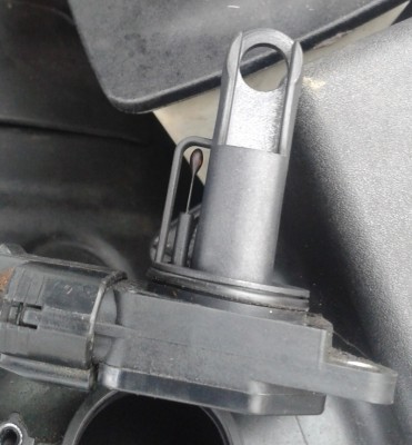

Removal of the unit from the mounting tube immediately after the air filter is easy. Just two small Torx head self tapping screws into the air flow tube. Remove those and lift out the sensor. Pics here show that the filter face side of the hot wire was filthy with black gunge. I cleaned this off with alcohol panel wipe and a very soft paint brush. Normally I would have used spray carb cleaner but I had non to hand. Cleaned up, you can see the bright clean hot wire as it should be as in this image. Fitted back to the car, I cleared the fault codes and drove the car. PERFECT with no further glitches coming to light. Hopefully I now have a permanent result. Again time will tell.
Right now I believe the MAF to have been out of limits due to being extremely dirty. I also suspect I had a poor connection to the temperature sensor or the sensor is somewhat tired. A sluggish old thermostat may also have had an impact on the general heat flow through the coolant system. The stat has been changed for a new item and although all appears well presently, the temperature sensor will be changed when a new one arrives hopefully tomorrow.

Continued minor faulting still present today which is happening as the engine reaches half warmed up, ie the first quarter segment on the gauge with the original suspect sensor still in place. iCarsoft unit is permanently rigged into the OBD port to clear the fault when it occurs. Once fully warm and the initial fault is cleared, the car appears to be ok until I switch off, come back to the car for say a return home, where upon the warm up fault starts all over again. Then it will clear for a couple of days completely until things go AWOL again!
XJK supplied me with the 4 litre 12.5mm temp sensor (LRA1600BA) which when fitted refused to let the car even start. So the old one back in yet again!
XJK who are jolly nice chaps are now supplying an LNA1600AA which they tell me is a sensor applicable to my Vin No of G33305. The info was apparently quite deeply buried. This should arrive early next week and I`ll try and clear the fault with this unit.
Later cars would appear to run the larger 14.5mm threaded sensor which is the commonly seen AJ8 10031.
Worth also noting that the MAF hot wire and bulb clean up together with a good clean of the plug and socket appears t have given the car a noticeable increase in low speed torque and more reliable and spiritly get away from a standing start. Those having followed my posts since I squired this car might recall I have always had a groan about lack of low speed grunt. The MAF sensor cleanliness issue appears to be extremely important in keeping these cars running well. We live and learn.
