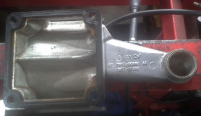

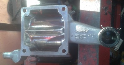

The "cowhorn" manifold has now received as much attention as I can give it. It is as good as it will get and of vastly better finish and profile that it left the factory. I managed to remove a fair quantity of metal from the by-pass throat, cut back the sides of the pressure outlet which were unequal and bore little resemblance to the gasket. More material was removed from the by-pass outlet before I smoothed out generally and polished up. My finger slides without resistance across the internal polished surface. That will do no harm at all.
A few pics here.
After my first rough out session.
As it is now. Careful examination shows what I started with and what I finished up with.

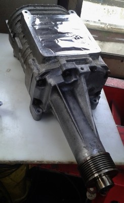

Charger collected today from Jagcare.. The valley pipe certainly needs replacing. Simon and Charlie seemed unfazed by the difficulties and Charlie proudly said he had done three X350R charger removals now. He considered the S-type R to be an even tighter car to work on. He thanked me for buying an X350. Had it been an STR, he would probably gone on sick leave!
Back here by 10.00am and the next two hours spent cleaning the charger of gunk and also the throttle elbow. Rather smaller than the one I had been practicing on and as I later found, quite an easy elbow to lightly modify.

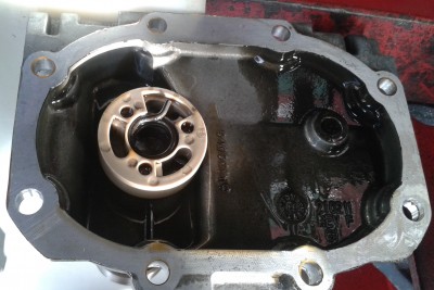

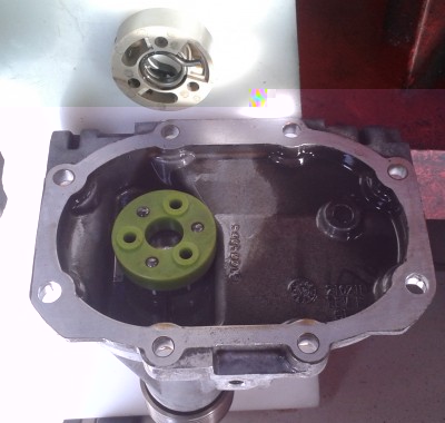

12.30 pm saw me draining the charger of oil which was in fair condition. Backlash on the OE coupling was significant. Otherwise the charger looked in fair order with rotor bearings checked for noise prior to removing the snout and the rotor pack from the casing. No sealer or gaskets used. Just a tight fit with thread lock applied to the bolts. The rotors have a few chips in the periphery coating and there are a few scratches in the internal casing. Pretty normal, I would have thought.
The rear needle roller bearings were in sound condition. The casing around the cages was cleaned with acetone and aluminum sticky backed foil applied across the front and inside faces to seal from metal swarf, dust and general machining muck.

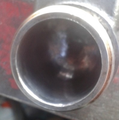

The elbow internal surfaces were covered in black sticky crank case breather residue. Engine cleaner then acetone had the worst of it away.

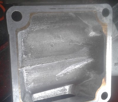

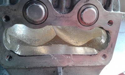

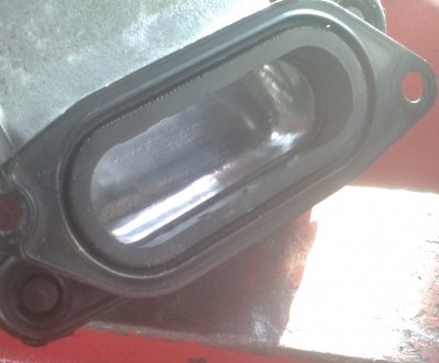

I used a marker pen to draw around the inside of the gasket between the charger inlet and the elbow. I had modified the gasket as per Lawson Smiths details in order to lower the elbow and charger floors to promote lower inlet temperatures and increase performance.

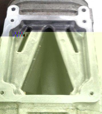

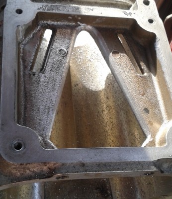

The porting work to the elbow, charger inlet and the pressure plate which is part of the charger casing went very well with no issues at all. I seem to have my technique sorted now. Even so, it took me five hours to port all parts. A small rework was carried out to the small end of the pressure plate V, opening up an area of rotor that was previously inaccessible.
This has been something of a rushed rework but a good basic polish of all areas has been completed tonight.
An early rise tomorrow will see all parts thoroughly cleaned again, thereafter the rotor pack, new up-rated coupling and snout case refitted together with a repack of the caged needle roller bearings. With eight or so bolts holding the snout and the rotor pack in place, these will be torqued having applied thread lock to the bolts. All that is then needed is for the special synthetic new oil to be poured into the charger via the screw in plug. Rebuild complete.
The best thing I can do then is either order a taxi and have the driver take the parts in a large kit bag to Jagcare or try and bum a lift from someone. Jagcare can then put the whole thing back together again. Lucky old them!
I`ll add images tomorrow. Tired, dirty, hungry and in need of a pint right now. Its all coming back together again gradually and not before time.

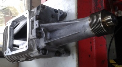

Pictures speak a thousand words. The work carried out yesterday and first thing this morning.

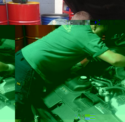

The end of a long hard flog! Bravo John and young Charlie at Jagcare. I don`t care that the car is covered in two weeks worth of dust and muck. I`m mobile again! That is a good enough result.
"The Beast" is back and running superbly. An extra big bit of low down grunt added which has transformed the car. Spontaneous pick up with the lovely trickling throttle response I had missed so badly since selling the Paramount S-type V8. Un-blocking inlet, charger and exhaust components has worked a treat. I`ve only driven the car in traffic heavy conditions yet, but so far the improvements have ticked all the right boxes. No more faulting or having to use the iCarsoft unit to clear down restricted performance every trip. Good riddance to the rotted vac pipes.
Upon re-assembly, the car started instantly. Charlie and I spent a few minutes clearing fault codes which had lodged themselves in the various ECU`s due to having to move the car around when loading onto transport and pushing the car into the workshop. No issue with that.

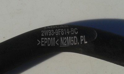

This image shows the notorious and well buried valley pipe which can disintegrate due to heat, age and mileage. In actual fact, mine all though only showing the first signs of ageing and 82k miles of use, is still in pretty good nick. Taking the opportunity to replace it makes me feel a lot happier. I consider I would have been a mug not to have had it changed. Fitting the new pipe is one less component on the car to fail over the coming years. The part number is 2W93-9F814-BC and am told it is common to all 4.2R V8 Jaguar models. This is the pipe which runs from the back of the engine, along the NS cylinder bank before coming to a central point somewhere behind the thermostat unit. Failure of the pipe is usually first shows as a coolant leak. Ignored, the pipe can split open like a ripe banana sending torrents of scalding coolant in all directions. Not good on the motorway. In fact not good at all.
This is the first time I`ve done any charger porting and polishing although I cut my teeth gas flowing cylinder heads and manifolds. Porting the charger and other components was not difficult although I approached metal removal in the immediate area of the rotor inlets with some trepidation. Fortunately Lawson Smith had sent me some images showing the areas to work so all I did was copy his ideas. To my knowledge Lawson has not ever ported the cowhorn pressure plenum roof or cleaned out the restricted by-pass duct and entry. I must have another chat to him about that.
The up-rated coupling is a tad noisier than the OE component. I was warned about that by Lawson. The extra noise does not invade the car although one is aware of it standing at the front of the car with the engine running.
