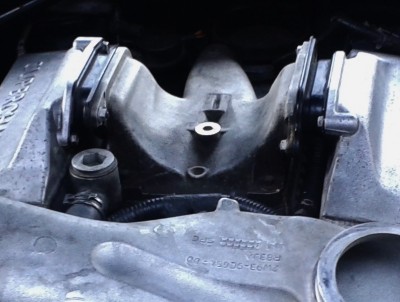

I collected a new MAF from Grange in Croydon. The part number for a supercharged 04 XJR is C2C7636 at a cost of £111 all in with a 10% discount.
I fitted the MAF but a little later the usual faulting returned. However, once I`d again cleared the DTC`s, the car seemed to have more extra low down grunt than at any other time in my short ownership. The idle was also a little slower and less lumpy than previously experienced.
Then Rob phoned to rub my nose in the misery offering to buy the car for his usual opening bid of ten fags and half a bottle of cheap whiskey. Having released I`d neither buy a car from him or sell him mine, the following advice was offered.

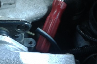

"Get yer great mit down around the back of the throttle body and find a small vac type pipe similar to the type of pipe we used to find connected from an inlet manifold to a distributor advance capsule on something like a 1970`s car. I bet you find it has gone soggy, split, collapsed, expanded or has fallen off the stub pipe on the throttle body".
My hands are huge so no chance of that happening without removal of the plenum above the throttle. It joins to the inlet pipe trunking and brings air from the air cleaner box. Despite being short of time, I tore off those parts in about three minutes flat. Note the inlet plenum (ie the one you see immediately you open the bonnet on top of the engine) is linked to the throttle body by a short length of rubber collar of about 3" diameter and is fitted with two of those horrible squeeze clips. I`ve previously removed those clips in favor of Jubilee clips which are easier to tighten in a VERY confined space. I use one of those flexi drive screw driver type tools with a 8mm socket on the end. This is normally the standard size for modern metric jubilee clips. I slackened the top clip to allow the upper plenum to lift clear of the top of the down drought throttle body then slide the plenum forward on its peg at the front of the engine before lifting it clear..
The area behind the back of the engine is very cramped and chock full of pipes, cables in flexi conduit, sensors, plugs, vac/pressure units, the throttle body and a MAP sensor. An EGR valve is also in there somewhere. Its a nightmare in a six inch square space. You need to spend a few minutes poking around to familiarize yourself before attempting any remedial work.
Below the upper plenum is the supercharger outlet plenum/manifold which feeds compressed charge air to the inter-cooler bricks. On the passenger side, at the rear of that manifold is an inch long metal 1/8" diameter pipe.......................IN MY CASE WITH NO RUBBER PRESSURE OR FEED PIPE ATTACHED TO IT!..... BULLSEYE in one shot. The pipe had fallen off the manifold pipe!!!! I recovered the rubber pipe from its resting place and cut off the first half inch as it had expanded over the years and was a loose fit on the metal pipe. That done, I nailed the whole lot back together again in double quick time. I started the car and counted to thirty. Normally this was one of two typical and critical times the car would fault. No issues at all. I took my Father to hospital and experienced one glitch having descended a steep hill on overrun. Another glitch took place twenty minutes after leaving my Father there for treatment and making a return journey. Back at his home, I lifted the bonnet yet again. Not wishing to dismantle the car again as I would have to return to the hospital within three hours, I idly fiddled and faddled around the area of that small rubber pipe. I`m not sure what I achieved in the process but the car ran faultlessly on both the collection on return journeys this evening. Twenty miles covered and no sign of repeated faulting. I now hope I am home and dry with these recent issues but as always, only time will tell.
