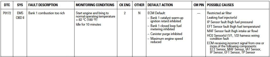

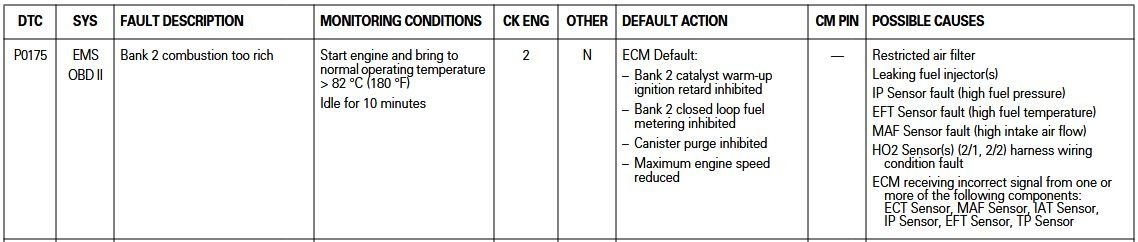

Re: Restricted performance
Hi Mike,
Here are the definition and possible causes from the DTC Summaries manual: Sorry I can't recommend anyone in North London but a lot of Jaguar owners on the X308 Facebook Group Page recommend S.E.Jags:
