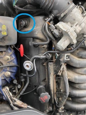

Assuming this little fella circled blue is the VVT solenoid, then yes
Is there a way to test these? Perhaps remove the electrical connector while running on either side and listen? There are no codes according to my iCarsoft LR II.

VVT has oil pressure as its basis.
I always use Wynns flushing additive when oil changing. It helps to keep sludge under control and to ensure oil galleries are kept clear. If your issue is oil/VVT related, a flush plus fresh 5W30 can`t do any harm at all. As regards the noise/vibration issue, further investigations can carry on once you know you have given the engine a bit of a clear out and refreshed the oil.
