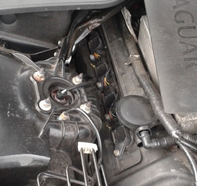

May I ask for your guidance as to how to get around the various obstacles on the passenger side please?
I believe I need to remove the pipes shown red and blue - and also get the yellow-marked wiring bundle out of the way to stand a chance of lifting the plugs... are the pipes safe to disconnect and will I need any special tool/clips to re-assemble? I can't see any single termination connector for the wiring bundle, so moving that seems unlikely.
I wonder whether you could offer guidance please?

That particular set up is fresh territory for me.
Ideally you do need to clear as much clutter as possible to gain working space. Its very tight at the back of the near side rocker cover so get as much peripheral gear out of the scene. Pipe clips can be a nightmare to separate and possibly need a few special tools to split them. Electrical plugs again can bend your brain finding out how they fix together. You will need some cunning for removing that rear plug as well as a piece of 1/4" bore pipe to extract the plug once you have worked your ratchet, extension bar and socket out of the plug well. A simple plug change on these cars can develop into an ordeal.
All I can say is that you need to gather as many hints, tips and wrinkles together from various sources. I recall removing that rear plug took me as long to do as changing three others which were vastly less obstructed.
You can depressurize the fuel system by pulling the fuel pump fuse. This will save spraying fuel everywhere when you eventually get the pipes apart.
Without seeing the car personally, I`m afraid I`m relying totally on memory from several years ago.
Perhaps Astromog or Brian might be able to offer further advice.

What year is your car? My 2006 (3.5 Sport) is rather different in layout compared to your pictures. It may be an illusion but it seems like your fuel line (blue bit in your photo) has been tied into the main engine cable loom (the yellow bit in your picture)? If so, then it does not make any sense to do this and I wonder if that is ex-factory or if a previous owner has done this. The (red) fuel line should be a loose pipe in its own right with just the coupling in the middle. The main engine loom (yellow) is held onto a bracket low down at the back of the engine by a tie-wrap. This can be cut to move the loom away to get more access (make sure to replace it later)

It’s a 2004 model so perhaps some changes...?
I’d appreciate a photo PM, thank you!
