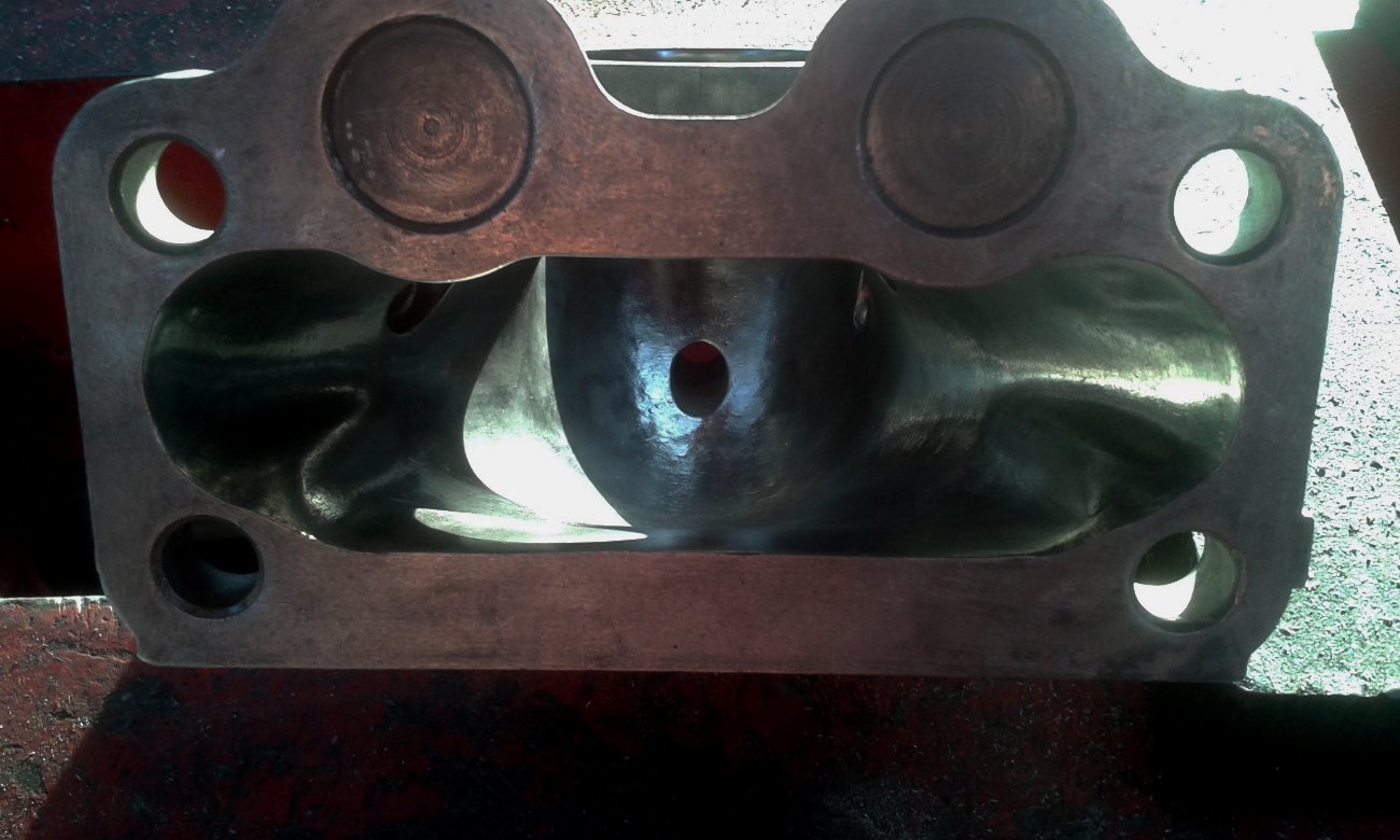

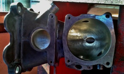

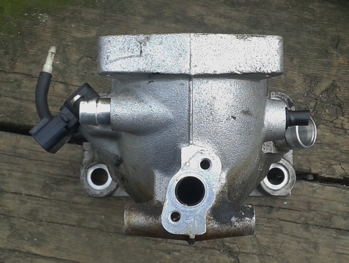

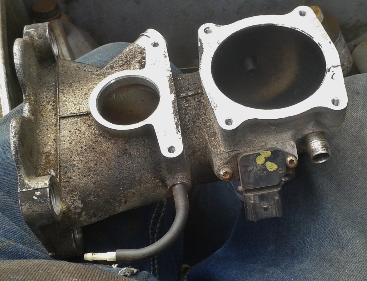

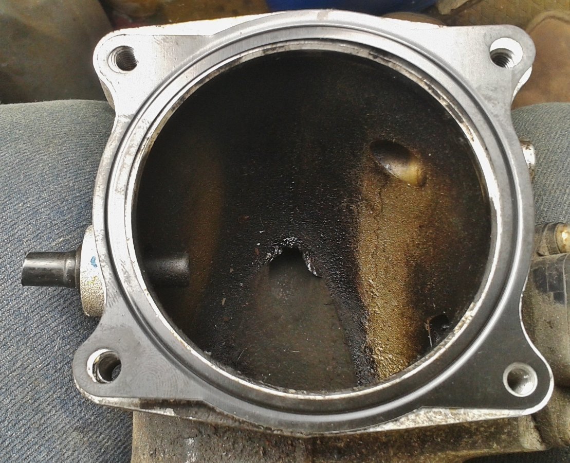

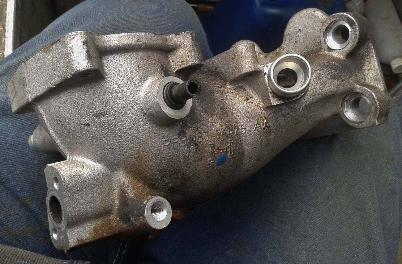

Some images here of the XJR 4.2R elbow showing the mounting point for the MAP sensor, the "trench" and the vac take off stub pipe for the 1/8" ID vac pipe. The MAP sensor fits on the back of the elbow. The throttle body mount on the top of the elbow is clearly seen. A metal crush gasket (must be renewed) sits between the throttle body and the elbow. All needs a good clean up to clean metal before re-assembly.
See how you get on.

The pics of the elbow above are in fact from an earlier 4 litre XKR rather than from the 4.2 XJR/XKR of 2002.5>. Slight differences but nothing to be concerned about. The pics show some porting and polishing mods I carried out for friend prior to opening up the elbow and charger cross sectional area by about 25% and reducing some of the volumetric strangulation from which a standard car suffers. Well worth a day with a die grinder and some cutting burrs.
