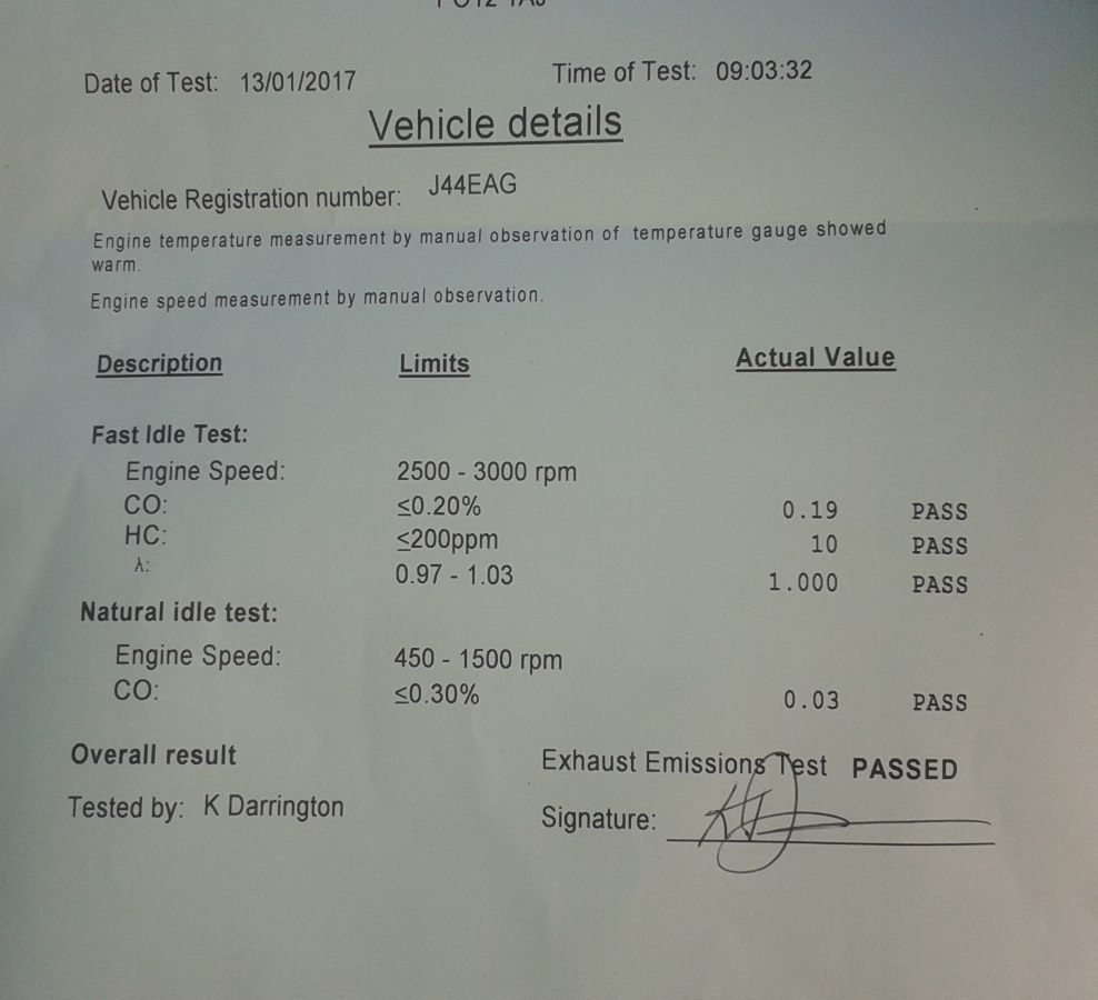

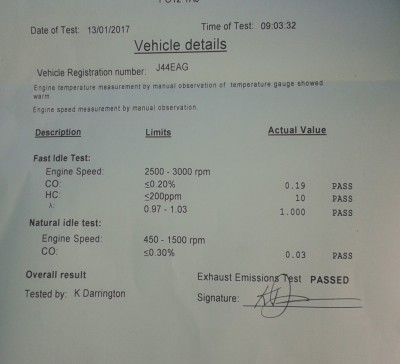

MOT this morning.

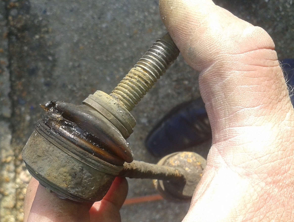

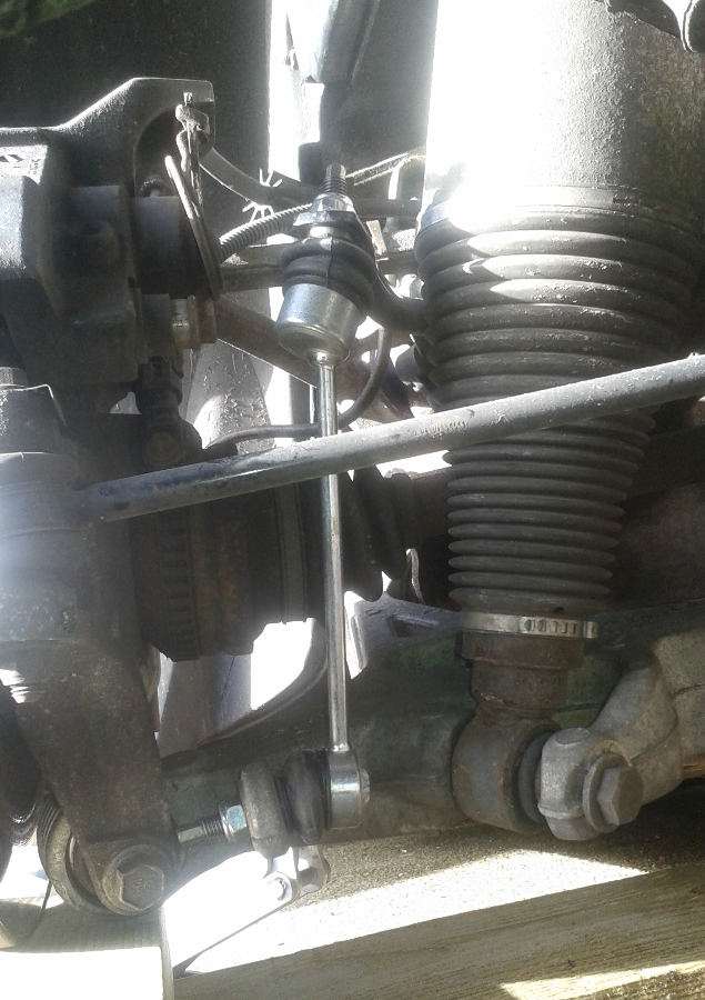

I had a small fail due to a split gaiter on the N/S rear ARB vertical link. One of the boots had failed at 86k miles and grease was discharging. Fortunately, I had a new pair of links having bought them last May but never fitted them. Once I had the rear wheels off, fitting was just a fifteen minute job for each link. No problem with that.

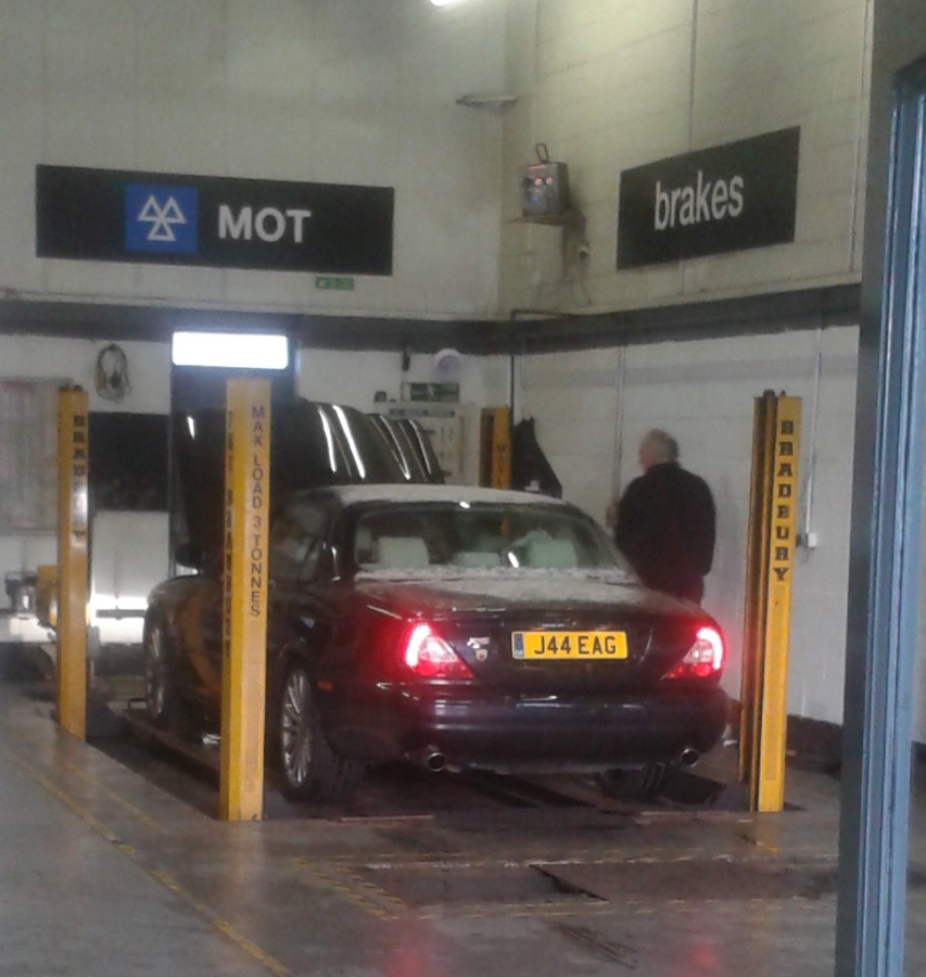

Fortunately I had an old school MOT man. The car initially failed its emissions test. I had over the limit CO output which we put down to the new sports cats. These need to be kept hot prior to the test. The car exhaust had lost heat due to standing on the examination ramp for 45 minutes. A call to Longlife Exhausts who fitted the new cats suggested we run at 3000rpm for four minutes and try again. The tester agreed and we tried again. This time CO was JUST, and only JUST, below the 2.0 limit at 1.9. So the pass result was a very close run thing. Fitting the sports cats also very slightly increased the HC figure from 4ppm to 10ppm.
This "work around" method is quite common apparently. The problem is that sports cats have a higher gas flow velocity than standard units. Standard units are so full of cat media that gas flow is slow and heat build up within the cats is faster due to the restrictive nature of standard 600 cell media. The sports cats flow faster and heat gets away quicker as well. That is what caused this slight issue this morning.

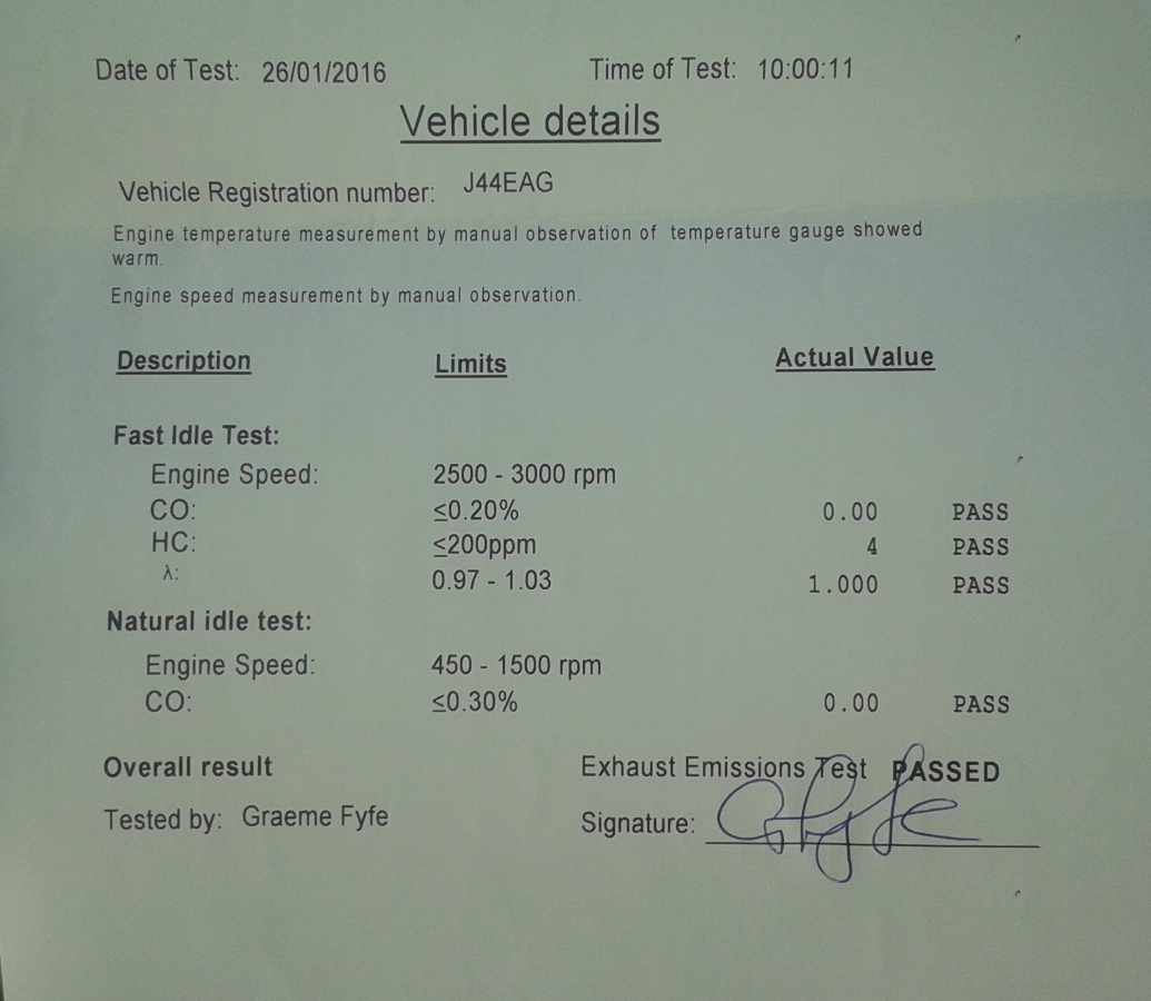

Compare if you will, the MOT results from my car last year with standard cats fitted and then the results from this mornings session.
So for next years test, I am suitably knowledgable to be able take this slight problem as it comes. Although a cold cat issue exists, heating before test makes a test pass possible even with highish CO levels still being a feature of fitting sports cats. It is a bit irksome, but that would appear to be the price you have to pay if you want this type of performance upgrade.
The gas test as performed at the MOT station is rather curious. One would have thought that doing the test immediately a vehicle arrived on site would be the done thing. I suggested this to the ever helpful Halfords tester and he said that it could only be done at the end of the session. Presumably to weed out cars like mine that may be border line on gas output levels.
Dan at Longlife Exhausts had other points to make. That was the age of the test machine, accuracy and degree of accurate calibrating possible on elderly test gear. He had dis-guarded an old machine recently in favour of a brand new unit. Results were as like a chalk and cheese.....So perhaps avoid a test station that does not have an up to date gas test unit. Even test gear can eventually loose the plot!
So now with a nice new test certificate in my hand, I`m set for another year of mayhem.
