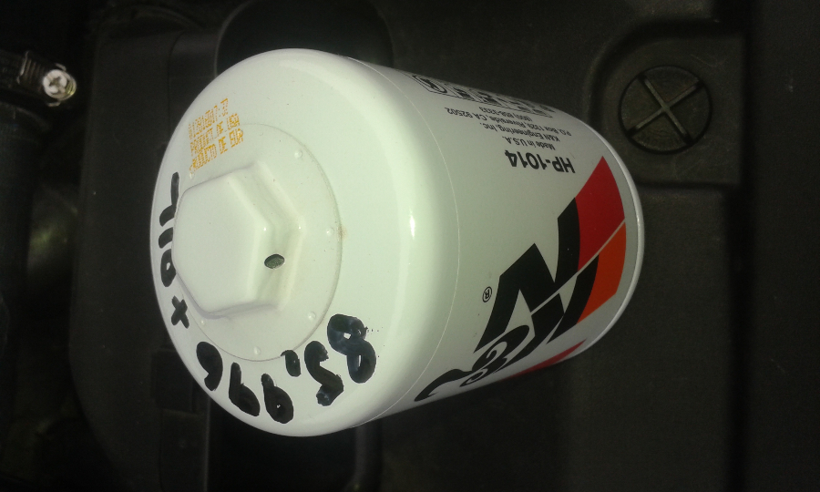

So new oil and my favourite K&N HP1014 oil filter installed. I wonder what the effect will be now? Will the oil now stay cleaner for longer than previously noted, or will it continually begin to blacken quickly again due to the continued cleaning actions of the water/meth kit? Interesting times ahead. What ever happens, I at least know that carbon and oil crud is being held well in suspension in the oil and that the oil I am using is doing its job ie keeping crud in suspension.
The K&N HP 1014 filter is currently available at a rock bottom price of £9.50 from Eurocarparts (Carparts4U) via ebay with free next day delivery. Great value, state of the art filtration media and anti-drain back valve as here. I`m using Wilko up to Jaguar spec, 5W-30 fully synthetic oil at what must be the keenest price around. Just £16 for 5 litres. That is around £5 cheaper than the equivalent Halfords brand. I make that around £23 for the 7 litres of oil, plus £9.50 for the filter making the total cost of the oil change around £32. Hardly expensive, is it? I don`t begrudge a penny of it.
