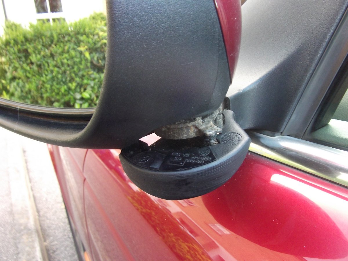

Manually fold the mirror forward as shown in pic below:

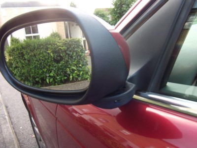

Then carefully wiggle back the puddle lamp housing remembering that there are wires still connected for the lamp:

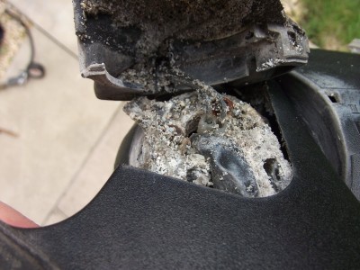

You can then remove the two wires and completely remove the puddle lamp housing. You may well be very surprised at the amount of alloy corrosion on the body hinge, hence the need for the towel!
Use a brass brush or similar and clean up all the corrosion then lubricate the mechanism and replace the wires and lamp housing.

you weren't kidding about the amount of corrosion dust it almost filled the puddle lamp housings! However having cleared all of that, wire brushing the mechanisms (yet more corrosion) and applying lubrication hey presto everything works properly again. I did have a little heart stopping moment until I noticed the passenger puddle lamp housing was not fitted properly and was fouling the mirror). All in all 30 minutes well spent, which I couldn't have done without your guidance thanks once again.
