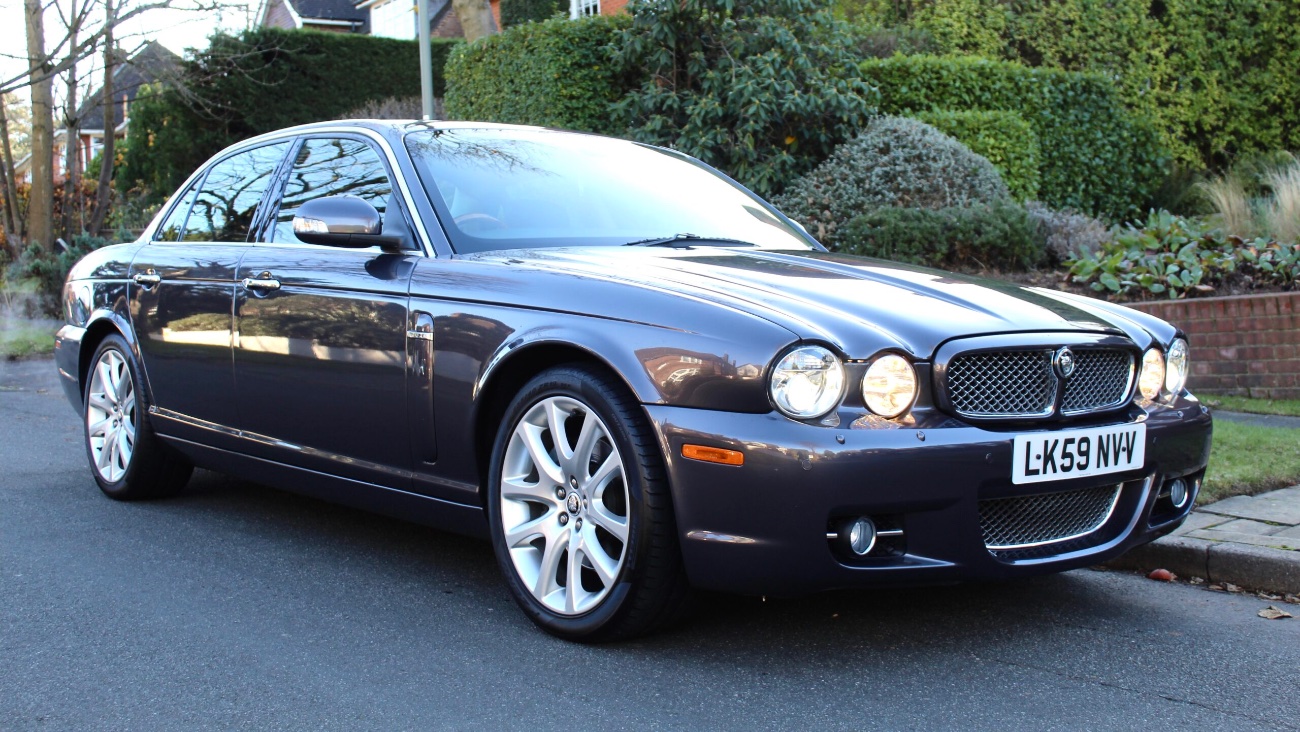

Pic attached. Being delivered on the 11th March.

Hi Ian, very nice acquisition. You should be registering to bring it along to our Scottish Jaguar Enthusiasts Day on Saturday, the 29th of June 2024 at the Riverside Museum in Glasgow. See the information on the link below. Any problems, send me a PM and I will follow up.

Lovely-looking car! Well done!
I loved my 4.2 X350. Probably the best long-distance everyday car that I owned.
I bet you're looking forward to it arriving. Let's see some more pics!
