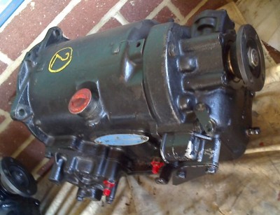

Hi Alec... Thanks for your quick reply. I seem to remember a cream coloured cable with a thick inner in it and a sprung outer in the parts box. Perhaps that's the speedo cable? Here is pix of the instrument panel front and rear.Image[/img]
And one of the boxImage
