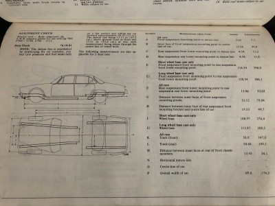

The Jaguar factory manual shows the wheelbase as 112.87", and offers instruction on measurement.
The problem is most likely a result of incorrect positioning of one / both radius arm posts. Unfortunately the manual doesn't seem to provide any positioning guidance:
