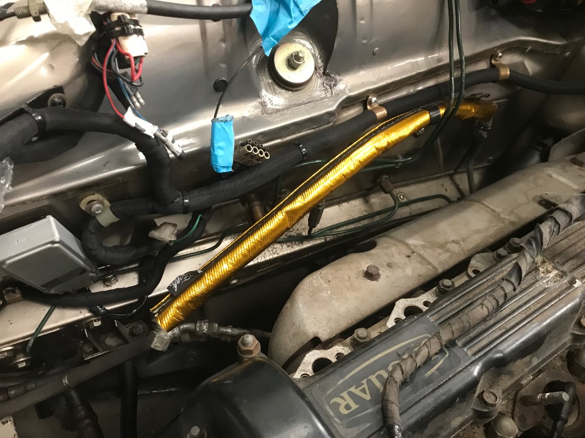

Postby V12Smig » Mon Jul 13, 2020 10:55 am
I have purchased some replacement lagging for several pipes on the V12, got these from a company called Funk Motorsports, have to say in gold they do look funky... you can also buy these in silver and in several diameters and lengths as well
