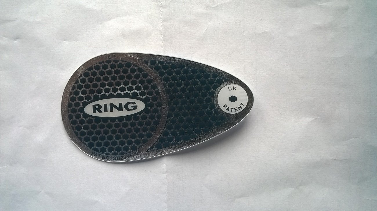

Nowadays you are sold something like this.. These are a "one size fits all" shape, do not require significant cutting and are impossible to fit precisely. I don't know whether they deflect the beam from the headlamp or block it entirely or do a bit of both.
I have kept a set of old LUCAS masks so I can use either system for my forthcoming trip to France in my 1971 sovereign (traditional round halogen headlamps). Can anyone tell me which system will be better for both my night time driving vision and for the oncoming drivers?

For what it's worth, I still use the old fashioned Lucas tape and recently bought an old stock pack on eBay to ensure continued supplies for a few more trips. This year I actually had to drive my coupe at night in France on unknown country roads with taped headlamps and it wasn't a pleasant experience! I couldn't see a thing.
Previously, I have also tried the oval style deflectors. If I recall correctly, one fell off, never to be seen again, and they weren't much better than the tape. Originally, I used to fit a pair of LHD headlamps for driving in France and they were great but it was a faff to do and considering that most of my continental holidays are taken during long summer days, it was a seldom used advantage. Sadly, those lamps have long since rotted away.
In part it may be my eyes deteriorating but I don't think that the modern replacement round headlamps are as good as the original 1970's Lucas halogens (those OE units with halogen written on the face in white), with or without tape fitted. The light scatter and beam patterns seem less well controlled for those currently on sale. Mike.
Re: Headlamp beam deflectors
Thanks Mike. It's helpful to know that both systems are as bad as each other. I think I'll use the modern teardrop masks and cut them to the (smaller) pattern of the LUCAS masks - that way I won't cover more of the lens than is necessary but will get a little light through if they are transparent.
