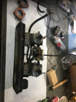

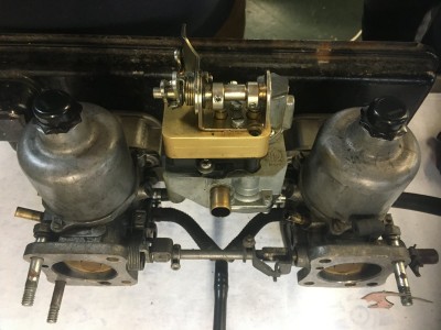

Hi, the images you attached still show the AED unit in place although with the manual conversion. The company is SC Parts (not SE Parts) which is a large parts supplier with dedicated catalogues for various models of Jaguar. I tend to try them when SNG and others cannot help me.
The part no on my invoice is 315467. The conversion kit is manufactured by Limora, a German based company, who provided comprehensive instructions in English. I have just checked SC Parts on line catalogue and the kit is still available but if you want to convert the later HIF7 carbs fitted to the S2 it may be best to ring them on 01278 457372 to see if they have a conversion kit for those carbs. Also worthwhile checking if SU themselves can supply the brackets and linkages to fit HIF7s?
