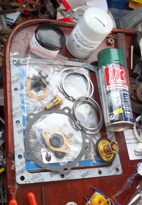

This is what you get for £505. Two piston ring sets, a head gasket and valve seals, a couple of filters, a water pump impeller and seal kit and a can of green paint! Piston rings fitted. Chrome plated ridge dodger at top, wider standard large diameter plain iron secondary compression ring in centre and oil control ring at bottom. General view of crank in block. Troublesome No1 main bearing to the right. Detail of No1 main bearing. Sump and front cover refitted and a squirt of paint. Engine back up the right way round again. head and some ancilliaries refitted, flywheel back on and more paint to tidy the job up. Today, Sunday, and self and owner exhausted, in pain and somewhat the worse for wear after last nights session. A distinct lack of enthusiasm being shown at this point in time...

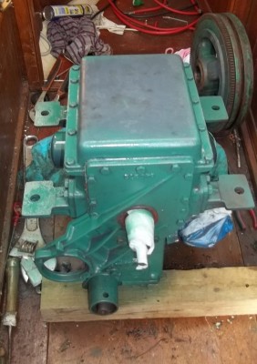

Back on the job again for a couple of hours yesterday getting the engine bed and bilge prepared for the rebuild block. Enthusiasm returned after a days rest and recuperation.
managed to get a couple of chaps from the yard to help me locate the engine back in the black hole. A surprisingly heavy unit only movable using a block and tackle slung from the sail boom. Engine back in again in five minutes. All then bolted down, propshaft connected to the gearbox and then all other ancillaries added. Not difficult. Just a lot of it.
Then jury rigged a battery, control panel, master switch and cables to the block and starter. Cranked first time, bleed down the fuel system and after a couple of false starts the engine burst into life. No leaks of any kind, runs hugely better than before and only a small amount of exhaust smoke. Ran the engine for a couple of hours without incident so tonight am well pleased. A shame funds were not available for a rebore and new pistons. That would have cost another £1000. So my pal has an operable boat again with an engine that will do the job.
Engine running without any issues. Nice to get a result. Time taken. About sixty hours. Mike
