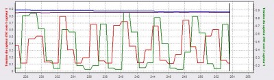

All,
I am back and I would like to point of view on my Lambda sensor mesurements from the OBD tool.
4 values have been collected. They are the 4 Lambda sensor data. The engine is cold, at iddle with some accel.
I am surprise to see the lambda at the output of the engine goes in oscillation between 0 and 1.
However, the catalysers are working well.
What do you think?[
