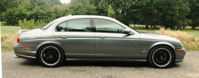

For the last year or so, there has been one thing troubling me. Despite all the excellent advice in the forum and magazine, I had never removed the plastic sill covers to see what rust there may be hidden underneath. To be honest, I was too scared to look.
Mr Cat had to go into the body shop last week for repairs to a minor rust bubble on the front wheel arch, a similar bubble on the rear n/s wing and a scratch on the rear bumper which appeared while parked. I decided to bite the proverbial bullet and I asked the body shop to remove the covers and report their findings. I had already decided that whatever they might find had to be fixed at any cost, so I was expecting to possibly shell out a significant sum to save my cat from the scrapyard. One glimmer of hope was that there was no mention of rust on the last MOT last February, so I had my fingers crossed that it wasn’t going to be too serious.
The car went to the body shop on Saturday morning. Monday morning my mobile rang... it was the garage. I can tell you my heart was in my mouth and I was very nervous when I answered the call, this was the moment of truth I had been dreading for over a year. So... imagine my delight and relief when the garage told me they had the covers off and there was no rust! They also checked all the known rust traps around the car and there was nothing!
This begs the question, why do some S-Types rust and others don’t? The garage believes it is down to keeping the car clean and jet washing the sills regularly. Even though they are behind plastic covers, the jet wash will get at least some of the mud and dirt out from behind or, more importantly, stop it building up in the first place.
Before replacing the covers, the garage rubbed down and cleaned the sills, coated them with primer, then applied stone chip paint and a liberal quantity of waxoil. This should ensure that the dreaded tin worm will be kept at bay for many years. Cost for the sill work - £100
Two lessons are to be learned here. First, not all S-Types rust and second, don’t put yourself through hell wondering... get those sill covers off and check for rust... it may not be as bad as you think. I wish I had done it a year ago.
