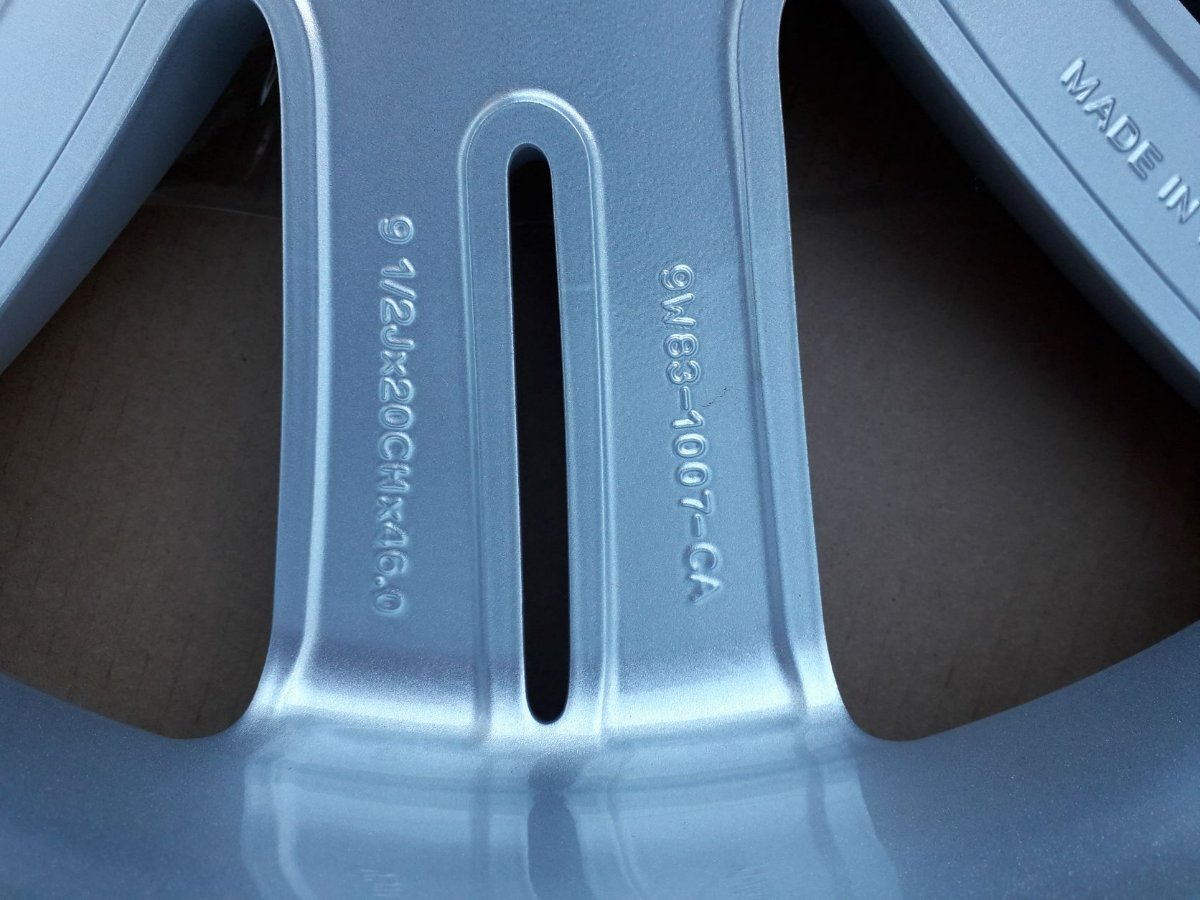

In regard to adding photos, first you need to reduce the resolution. Call up the particular photos you want to include and then by right clicking within the image you usually get presented with a "resize image" window (I don't use Apple, so this is for PC). Click on the middle resolution and save it where you can find it. Then in the "Post Reply" window on here, if you look immediately below the text box, you will see 2 x Tabs. Options and Attachments. Click Attachments, making it the lighter coloured Tab and then click on the "Add Files" box. Then it is simply a case of browsing to the folder where the image(s) are stored and adding, like below:
This is the rear of the Nevis wheel for the XKR (rear).
