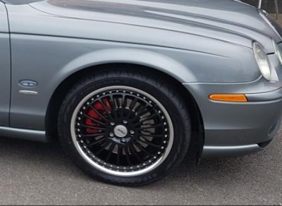

The rims are now fitted and look very nice I think, they have changed the character of the car completely. I have also added an "Adamesh" lower front mesh grille, smoked side repeater indicator lenses and some chrome exhaust trims, all from the same supplier. I have also ordered a mesh front radiator grille but I am waiting for that to arrive as they are spraying the outer rim to match the car. I
The wheels make an incredible difference aesthetically and the ride has changed slightly. There is a little more tyre noise at speed and the ride is slightly firmer, but not enough that it is a problem and I think only the driver would notice. My lady couldn't feel any difference as a passenger. With the standard wheels I had Firestone Primacy 3 on the front and Faulken on the rear which were about down to the tread wear markers. With the new new Firestone sport tyres the car feels more responsive with firmer, more positive grip in the corners. Whether this is just because the tyres are brand new or if the 245 width (as opposed to 235 on the factory wheel) has helped, I don't know, but once the tyres had bedded in the ride was an improvement. The wheels and 245 tyres certainly make the car look more aggressive as they now sit only just inside the wheel arch giving it a "chunkier" appearance, which i like. It has certainly turned a few heads already and had admiring glances
I even had a chap approach me in a car park to ask me if I wanted to sell it! I declined his offer
As I said previously, I am not a spirited driver ... that all had to change when I accumulated 9 points on my license ... 6 of those have expired now but I am enjoying driving slower. My thrill comes from the enjoyment of driving a car that makes me smile when I look at it
