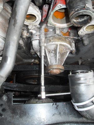

Front water pump bearing shot at 75k miles. Hence the leak. Pulley radial wobble was quite noticeable once the belt was removed. The same goes for the serpentine belt. Images below.

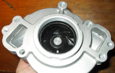

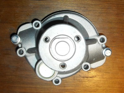

Just arrived from Neville- the generation 3 pump as fitted to the 4.2 V8.
A substantial revision with a very robust metal impeller, anti-frost core plug set at around the 7o`clock position and distinguishable from the early pumps with two bolts holding this two part unit together at the 4 and 10 o`clock positions.

Further examination now reveals that the core plug is primarily there to blank off a machining hole under a lower hole in the pump spindle extension. This was open to allow coolant to leak out on older model pumps but with possibly disastrous consequences. On this new pump any seal leakage will no longer just pour down the front of the engine. The design of new pump allows coolant in the event of seal failure to drain back into the cooling system and prevent fluid loss. Certainly a big improvement as leakage from the earlier pumps is difficult to see easily. Only a puddle of fluid in the nether regions at the bottom of the engine bay gives any visual indication that something is amiss.

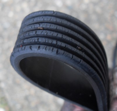

New pump on, new serpentine belt arrived and also fitted. This must be fitted around the belt tensioner pulley before any others. Then it is a matter of routing first around the air con pulley, then the power steering followed by the alternator before relieving the tension on the automatic tensioner unit before finally locating the belt on the water pump pulley. Tension is then let off the automatic tensioner unit and the belt is then checked for correct location in the grooves of all pulleys. The belt has to be fed via idler pulleys also. It is a bit of a cuss and a fiddle and took me about ten minutes work. Glad that is over.
Once the belt is fitted, the bottom hose can be refitted to the thermostat nozzle and the system filled with coolant. With the header tank full, I removed the thermostat tower cap, squeezed hoses to evacuate air and fill with coolant. The thermostat tower is then filled to the brim and the cap replaced. Further topping of the header tank may be required after an engine run and road test and establish the correct coolant level.

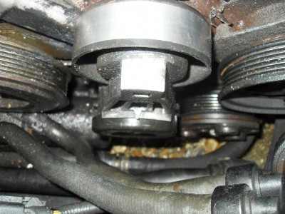

A few pictures here of the belt tensioner and the wear gauge markings which I highlighted in Tipex to make easier to see and to photograph. With the new belt fitted, the static pointer on the vertical tensioner arm points to the extreme left hand marker. As belt stretch occurs the pointer will move to the right and typically point at the centre scribe line. With no belt present the pointer will relax towards the right and point off the scale. The belt I removed had covered 75k miles and the pointer was just to the left of the centre scribe line. (JPG 802) So there was some life left in the old belt but it showed cracks across the lengthways ribbing so was replaced as preventative maintenance.
