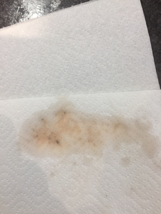

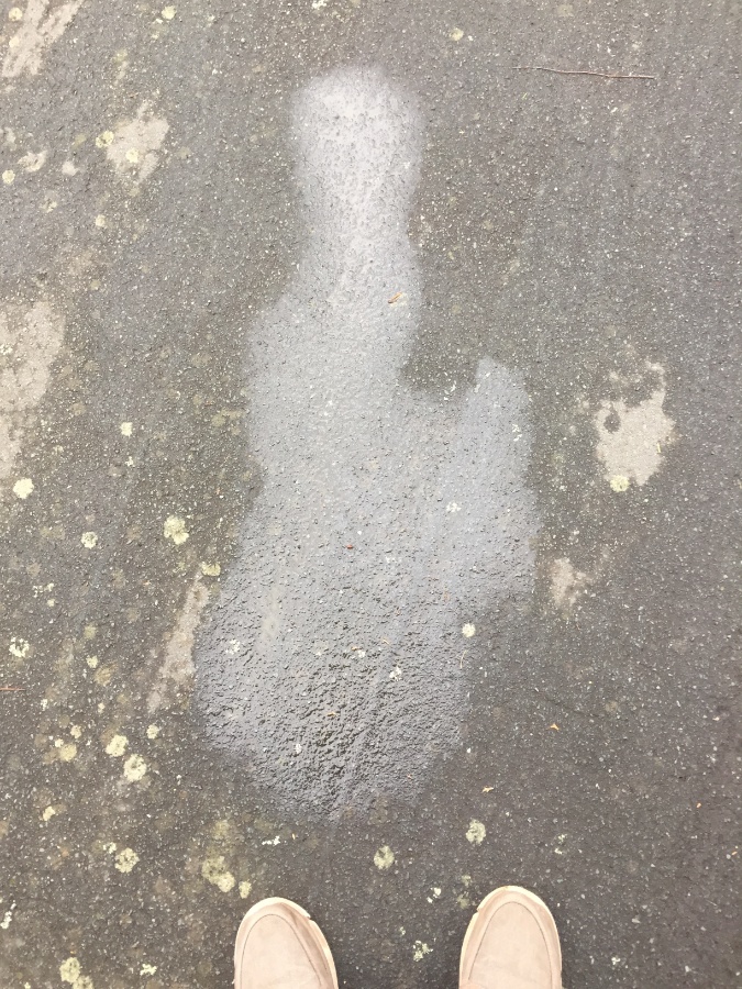

Well the S Type is staying true to form. Now leaking Coolant. It has been losing a small amount over the last few weeks and I put Rad-Weld in to see if it would stop, it didn't so another dose of rad-weld went in and it stopped but only for a week. I looked all around the engine bay with a torch whilst the engine was hot to no avail. Getting under the car to look is not an option for me and there were no puddles to help. I was beginning to fear the worst case with no obvious evidence, of cylinder head joints. However today I had a puddle. After a short drive to get some softener salt I parked the car took the salt indoors and charged the softener up. When I returned to the car I noticed a puddle slowly forming under the engine bay. A sort of relief felt. Backed the car away, got a tissue and soaked up some of it and this confirmed the colour orange. Fairly comfortable that this is Jaguar Anti Freeze fluid. Moved the car back to the yard where it normally parks and saw on returning to the puddle another smaller one where I'd previously backed the car. Went around to the local village garage along with the tissue and Chris one of the mechanics immediately said Anti Freeze. Booked car in Jan 3rd for a look-see and repair.

I had an expansion tank crack on a previous 3.0L Petrol 1999 model, does the 2.7d 2005MY have the same problem. The puddle is located it seems, I can't get under the car. from more or less the rear of the under tray area, is there anything above there that's prone to leaking, heater matrix? I hope not!.

Yes they too are prone to cracking and also leaking from the bleed screw, though I think you would see discolouration around that.
I was more thinking about wrapping a cloth around the Tank and run the engine to discount a leaking Tank.
