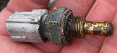

At Weston Park my 4litre S-type staggered onto the site with an apparent overheat condition in progress. Numerous stops along the way but the three other Co-ordinators with me in convoy were not convinced that the engine was overheating.
The effects seen were a low coolant level and message centre on the dash displaying "high engine temperature" together with a temperature gauge showing a needle deflection fully into the red. The radiator fans were constantly running. Only a fool would normally drive a car with that showing. Hence the numerous stops each time the gauge suddenly went into the red.
Eventually we decided that an overheat was not in progress so continued to the show. Thanks to Tony S, Hugh, and Patrick for their patience and support for those fifteen miles or so.
What went wrong. Simple. The temperature sensor in the top hose manifold decided to die. This permanently lit the dash message centre, the low level lamp, sent the gauge into a fit and switched on the fans. Fuel control issues were also evident. Dave Marks confirmed with his Autologic that engine temperature was reasonable and Bob Bate said he had seen the same thing several times.
So I dove back to Portsmouth with the dash lit up like a Christmas tree. Very disconcerting as I think you might agree. Next day the engine took some persuasion to fire up from cold and stalled a couple of times. The above symptoms from the gauge, lamp, message centre and fans were there as soon as I turned the key. Obviously the cold start fueling didn`t kick in as a hot signal was being read by the control ecu. Hence the reluctance to start until some cranking over fueling had occurred and some heat was generated within the engine. Hence the stalling. I`ve never experienced that before.
Zareef at David Manners was at the show and the next day sent me down a replacement sensor. £13.66 including delivery. Fitted in five minutes, normality has returned. Thanks to Zareef for that.
My car had run 77k miles before the sensor gave up the fight. On the basis of that, you may like to consider changing that sensor on a V8 if the mileage is similar or above. When that sensor fails, the effect is far reaching. Another smidgeon of knowledge to the pool then. Note there is a Dowty seal fitted between the sensor and the coolant manifold in addition to an o-ring on the sensor. Belt and braces anti leak technology!
Alls well that ends well but it was not funny at all at the time. I`ll put this saga in the magazine in time.

Thanks for the heads up and the photos of what it looks like. This kind of information is invaluable in these challenging economic times and well worth the time to write it up.

I had been chasing misfires since November last year. Typically the car would cough and splutter slightly on light throttle on an incline. I`d have to kick down to a lower gear to "drive though" the problem. In addition power and torque would decay as the gradient was tackled. Movement of the throttle pedal was non linear and rather disconcerting.
I tried everything to clear the issue. Cleaned the MAF sensor, ensured the throttle body multiplug was making good contact, changed the plugs but not any coils as I didn`t feel this was the problem. All induction pipe clips tight and nothing else appearing to be hanging off.
Having now changed the temperature sensor, the car is much more tractable on inclines. It also seems happier and more settled. My opinion is that the sensor had been going duff for quite a time. It feeds back to the power control module the temperature of the coolant leaving the cylinder heads which has a bearing on ignition and injector timing and also mixture control. That fact became clear when the sensor failed completely and with a cold engine, I had a devil of a job to get the engine to start. Gauge in the red, low level indicator on, message centre on, fans on etc. In other words no starting enrichment available as the ecu thought the engine was overheated.
Clearly this temperature sender operation and functionality is vital to how the 4litre V8 performs. Strangely, I`ve not read anything on this or other Club Bulletin Boards about this sensor issue before which tends to suggest this failure issue may be a rare occurrence. So there we are. We now know from my experience that such problems can occur and how to fix the issue if it does come up.
Interestingly on P30 of the new July 2012 magazine, I note that Colin Margetson has experienced the issue with his MY04 plate 4.2 XK8 so may be the problem is more common than we have yet seen.
