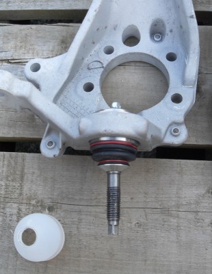

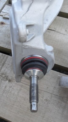

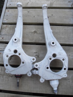

Here we are. This is what I bought for under £70 delivered.
A true ebay bargain if ever there was one. Note these units are for the earlier S-type only, with the ball joint within the leg. Later cars together with X350XJ and XF models having an inverted ball joint mounted within the lower drop arm.

Have to say I`m well pleased with my purchase. Just the old rivets for the dust shields to drill out and these units are ready to fit straight to the car when the need arises. I would appear I have paid about one third of the going rate for a pair of recon items.

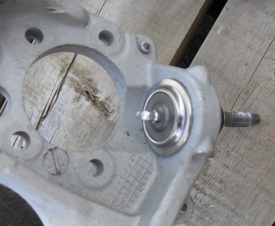

These are the rivets needed for the dust shields. 6 off (3 each side) required.
Part number is C2C4400. Either from a Main Dealer or in this case, Black Country Jaguar.
http://www.ebay.co.uk/itm/XJ-XK-S-Type- ... 256729d54f
The remains of the old rivets can be seen in the images above. They need to be fully drilled out. The person who removed the dust shields previously, failed to use a correct size drill bit, thus leaving the bulk of the rivet still in the vertical leg.

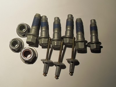

Further to my post above, I ordered six rivets from Black Country Jaguar for £10.24 inc post.
This kit is applicable to pre MY52 plate cars with ball joint mounted in the vertical leg.
Delivery was next day so full marks for that. However, what arrived was curious! Three rivets, six dry locktighted bolts (four needed for the wheel bearing cartridge, two,location unknown at present) three assorted nuts presumably for the steering drop arm and two ball joints at the top and bottom of a single vertical leg.
Curious indeed. Not quite what I ordered so I phoned up BCJ. Not a problem they said and sent me another kit in the post! So I now have the six dust shield rivets plus six assorted nylock nuts and twelve bolts! Not bad for £10.24 in total and enough parts to do two legs!
Image below shows one complete kit for one leg. Two kits will be needed to do two legs. Rivet mandrels are 3mm OD, so a pretty big pop rivet tool needs to be sourced to fire the rivets off.

Dimension details for unpulled rivets as follows.
Pull shank mandrel diameter 3mm OD
Pull shank mandrel length 35mm
Rivet grip length 19mm
Rivet diameter 6mm OD
Preformed rivet washer covering dust shield plate 19mm OD
Rivet material aluminium
Pull shank mandrel, plated steel.
Part number W7011950S100, forming part of kit JAGKNUCKLESUB which includes wheel bearing nuts and bolts from Black Country Jaguar. (Graham Taylor)
