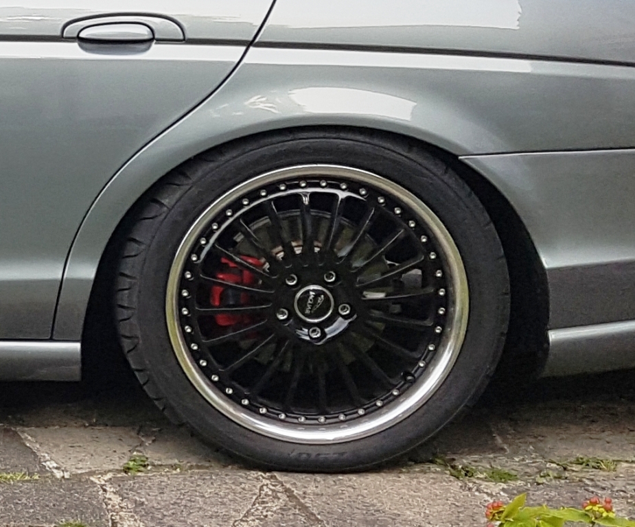

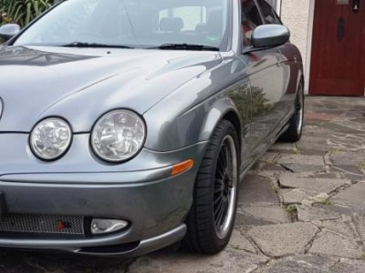

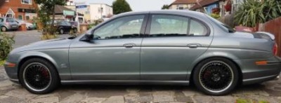

We discussed the possibility of lowering my S-Type slightly and you said you had some spare shorter springs that were surplus to your requirements. I don't want to alter the ride too much, so will I be able to use the existing dampers or will I need to fit different ones?

Yes, Les. I have the Adamesh spring set here somewhere which I took off my V8 S-type. The springs have only covered about 30k miles. They should give about a 25-30mm drop. I used them initially with original dampers and then with a set of 30% uprated B6 Bilstein units. The ride with the OE dampers and Adamesh springs was certainly more controlled without being uncomfortable. Body roll on roundabouts reduced considerably. With the B6 dampers fitted to those springs, a much more sporty and direct ride transpired. I liked that set up very much indeed.
