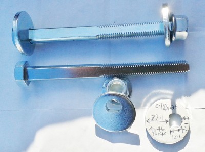

Better news on the delivery of the Moog caster/camber bolt and washer kits from New Jersey in the USA. Just one week from placing the order via Amazon and delivery here this afternoon. So two kits (two bolt and washer sets per kit) received for the accurate setting of the lower front wishbones in the two front cross members. Images here of the parts with comments. Quality looks very good indeed and instructions also for fitting. I have written dimensions of one of the washers for interest. Of note is the flat machined on the bolts and the fact that the hole in the washers are D-shaped to allow accurate suspension camber to be adjusted within 3 degrees negative and 1 degree positive. This four bolt and washer set came to me for £42 including taxes and carriage. God bless Uncle Sam! No sitting up geometrical markings figure on the washers. Even approximate general guide marks would have been useful....but each car is obviously likely to be slightly different to another. Final tracking, caster and camber checks might be needed at the end of installation. Total bolt length from below the bolt head is 151.25mm.

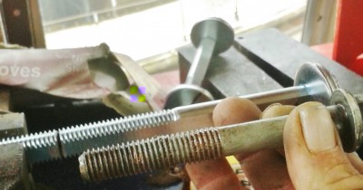

Nominal bolt OD is 13.8mm.
The machined flat measures 10.32mm across the flat. This reduces the nominal original bolt shank OD from 13.8mm to 11.88mm
The plain portion measures 70.00mm in length.
The threaded portion measures 81.25mm in length.
The bolt hex head measures 21.88mm across the flats.
The locking hex nuts measure 20.88mm across the flats.
The circular washer OD is 41.35mm.
The washer is 4.46mm in thickness.
The distance to the flat of the D shaped hole from a washer outside edge is 22.1mm.
The distance from the flat of the "D" is 12.mm giving a washer to bolt running clearance of 0.22 mm.
The distance from the circular OD non machined plain portion of the bolt shank to the outside edge of the washer is 7.1mm.

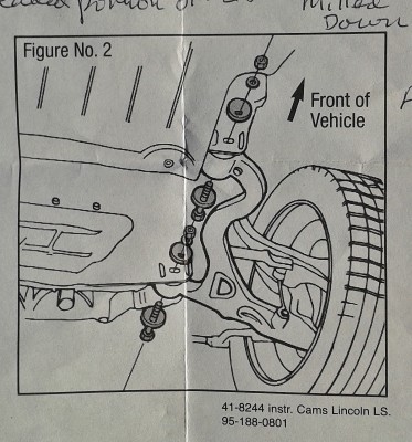

Basic instructions are included with the kits suggest that one starts with the washers being installed with the "taller" proportion being installed in the "neutral position". One assumes without further information provided that this might give zero degrees camber and perhaps a similar figure for caster. I shall be looking at initially installing zero camber and then set the correct amount of set back to ensure I have exactly 95.5" rim to rim edge between my front and rear 19" wheel rims. This should give the correct 114.5" centre front axle to centre rear axle wheel base length. That done, parallel front tracking will be set. Sadly when the Ultra Racing braces do turn up from Malaysia, I shall have to remove the rear lower front wishbone bolts yet again to fit the forward most brace. Irksome as it may seem to have to do the bolt removal and refitting yet again, I take some comfort from knowing that I will have perhaps had an easier initial set up run without the brace bar possibly adding to difficulties of finding out how best can be obtained from this Moog camber/castor kit. Its all good fun at the cutting edge of S-type modification. More soon.

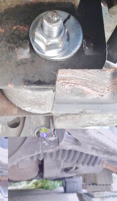

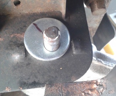

First job was to remove the two front lower wishbone bolts and replace with the new Moog kit bolts and cam washers. Approximately one inch trimmed off the total bolt lengths to just over half an inch longer than the original bolts. This was to cater for the two new thick cam washers on each bolt and to ensure I had plenty of thread remaining after nuts were tightened. Excess can always be cut off. Fitment went very well and I was able to adjust caster by turning bolts and encouraging the front bolts to move inward along the front cross member and gain the required the required 114.5 inch wheel base length. I used the new bolts and washers to move the bolt along the cross member slots and obtain the wheel base length. Front wheels now sit reasonably well and equidistant within the front wheel arches.This is the near side front caster bolt showing the index mark at approximately "2 o`clock" which gave me the correct wheel base length and hopefully a reasonable caster setting. Further adjustment took place after several camber and tracking adjustments following the work below. The new kit is in my opinion a "must have" if you choose to disturb the front suspension on an early car.
Index marking the washers with a marker pen makes CONTROLLED adjustment very easy and the washers add security to the somewhat suspect "bolt in slot" methodology employed on the early type front suspension. Equal adjustments to both sides of the car are possible with this Moog kit. I`m well pleased with the kits and at around £42 delivered with taxes paid from the USA, it is excellent value for money. 10.9 hardness for the bolts as well. Good stuff.
From my perspective the bolt kits provide not only easy adjustment but a hugely improved method of anchoring the suspension components to avoid bolt movement along the slots. This is of major importance to J44 as the bushings are hard competition grade and chances of wishbone movement are greatly increased. To aid the rear front lower wishbone location further, the fitment of my recently ordered Ultra Racing braces will further add to suspension integrity and security. That front lower wishbone takes a lot of punishment in service and needs to be well secured especially when hard bushings have been fitted. Classic knock on effect of uprate one part and others also have to be improved.
My attention then turned to the rear front lower wishbone bolts. To allow them to be removed, the three steering rack mounting bolts mush be fully slackened to allow the rack to slide rearwards along the mounting bolts and enable the wishbone register bolts to be removed. If the rack is not moved rear wards, the wishbone bolt is almost impossible to extract. The shot here shows how the bolt head runs into the rack bellows despite dropping the track rod end and attempting to position the rack end by winding the steering to a best position. Easier in my opinion just to slacken off the three rack bolts and gain the clearance. Also displaced were the two track rod end securing nuts which join to the front vertical hub carrier and which also provides more space for wishbone bolt removal. Once again prior to fitting the new bolts and camber washers, I trimmed an inch off the length of each bolt. I suspect these are standard kit bolts which may appear in a number of different kits and the manufacturer chooses to just hold one universal bolt length. I`ve no objection to having to cut a bolt down...its rather more difficult if a bolt is too short! Here is a shot from the N/S front bolt looking back towards the rear wishbone register with a nut removed from the bolt and clearly showing the camber adjustment slot in the rear cross member. The rear kit fitted, I moved onto setting the car up. This can take several attempts before caster, camber, wheel base length and tracking all come in together. An understanding of what is required is essential as is a good eye for alignment, perception and patience to allow attention to detail. One has to work methodically and assess the effect of dialling in any camber, caster or tracking alteration. Assistance with taking wheel base measurements is useful as is having someone else with you to help track the front wheels in line with the rear using an on edge tape measure. This allows a reasonable degree of accuracy to be obtained with all the hard work done prior to taking the car to a garage equipped with state of the art four wheel tracking equipment for the final tweeks. I used a gas blow lamp to heat track rod end lock nuts and flooded with WD40 to ensure I could easily make adjustments to the tracking with the car back down on the ground. Nothing worse than fighting stiff and corroded adjustment points.
