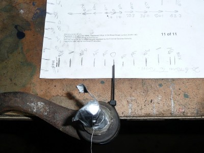

This time I pushed the car back and took readings and then forward for the second reading with the intention of getting both readings within tolerance. This also give a fair indication of wear and slack in the bushes, slightly more movement between the rear readings than the front readings. Thats the nice thing about having your own equipment, you can spent time trying different ideas without spending a fortune in a garage.

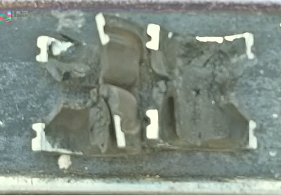

Some detail pics here of the front lower wishbone and bush from an early model. The bush itself is similar if not the same as that fitted to the pre face lift, facelift, X350 and XF banana arms found on the later front suspensions found on those later cars.
The bush register shown here is the front one (immediately adjacent to the lower corners of the radiator on both sides of the car) in the early type lower wishbone. ID of the register is 2.702"/68.63mm. Here are the internal parts of the bush I removed by cutting out with a hacksaw from within an ali tube outer case which is pushed into the 2.702" register above. Regret to say I no longer have the outer case available to photograph or the tube that is set within the rubber Metalastic part of the complete unit. This bush was removed due to the damage caused from my previously recounted pothole incident.
Only after three further years was the damage to the bush internals discovered and the fact that the two white internal compliance compression inserts were missing! The front of that lower wishbone had excess movement in it after the incident, caused tyre wear, slightly odd handling with a propensity for the car to wander slightly. Not good. Generally though these bushes hold up well in service. Owners rarely have issues with them. It was the pothole damage that killed this one off. This article quite ably describes the improvements to the S-type as development work on the original chassis progressed.http://www.google.co.uk/url?sa=t&rct=j& ... GU&cad=rja

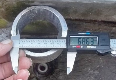

I`ve fitted the RG109 spherical tube replacement bushes to worn out lower rear wishbones without much difficulty using heat from a heat gun together with my bush removal replacement kit. The only thing you have to watch is that the distance between the virtually solid constructed new bushes is reset at 281mm as detailed in the big article I wrote on the subject.
Knowing as I do the design of that bush so well having sectioned one of them for examination, I note that most poly type after market producers also sell poly replacements for those special bushes. I can`t say i`m that happy about going in that direction. The original patent bushes are likely to be rather more solid than any poly type and in addition the original spherical bush is designed to handle some pivotal radial movement to allow for rear tracking adjustment. That is not possibly with a double top had and tube type poly bush which would always be under an offset side load all be it relatively small. I suspect lifespan might be limited with such fitment. With the patent bushes only costing around £40 each (two needed per lower rear wishbone) they are hardly expensive for the engineering within them. So no poly bushes in that location for me I`m afraid.
I`ve not yet removed the smaller of the two bushes in the lower front early type wishbone. I suspect it may need to be destroed in the process. I`ll see what I can achieve with that bush removal shortly. Again the distance between the two bush ends is critical. Get it wrong and the wishbone will not refit into the two mountings on the front subframe assemblies. Removal of the bush having removed its centre tube was straight forward with a little warming with a heat gun. That great chunk of rubber once removed just leaves an ali thin wall tube within the wishbone. Either the bush removal kit can then be used or a slit cut in the tube allows it to be tapped out of the wishbone register.
The interesting thing about some of these Powerflex type alternatives is that they are frequently simple top hat type bushes, one inserted each side of the wishbone with a single central tube for the bolt slid in after assembly. That is useful because that means you could rework a worn upper wishbone, either front or rear which has an all good ball joint still present. When that joint then fails, the Powerflex bushes can be salvaged and if desired easily then fitted to a new or otherwise serviceable replacement unit.
Generally these poly type replacement bushes are about half the price again compared to original units.

Just to add a bit more to this theme whilst I remember. I've written elsewhere that I have now seen 3 'L' chassis number cars upto ours at L83--- and all have ford steering racks and Getrag 221 gearboxes.
I have borrowed Roger's spares car steering rack and reasonably accurately measured the 'Variable Ratio' of the rack either side of zero (dead ahead). In 1/4 turns of the input shaft and the rack moves:-
0 - 1/4 10mm
1/4 - 1/2 12 mm
1/2 - 3/4 14mm
3/4 - 1 14mm
1 - 1 1/4 13.3mm
Total turns lock to lock is about 2.65 ish
About 10 degrees of steering wheel movement to correct side winds is 1mm of rack movement, that must be due to suspension bush movement (tired soft bushes).
below is my 'accurate' measuring equipment!!
0 - 1/4 10mm
1/4 - 1/2 12 mm
1/2 - 3/4 14mm
3/4 - 1 14mm
1 - 1 1/4 13.3mm

Two types of rack bushings appear to be available for the early cars. Presumably a different type for the Ford and ZF units.
Great appliance of science as regards your test equipment. Nice one.
