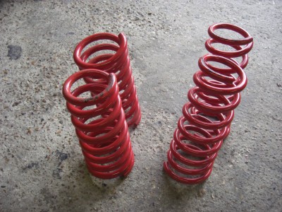

Three images here which show the effect of the lowering springs.
Graham Searle`s 4.2 V8 PUS on left with lowered J44EAG on the right.
Comparative of black standard and red lowered spring unloaded length. Mike
