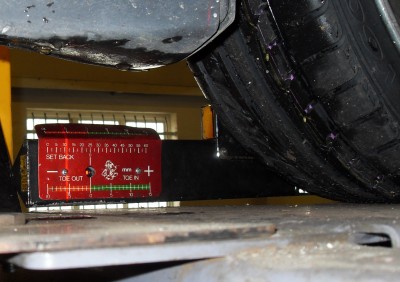

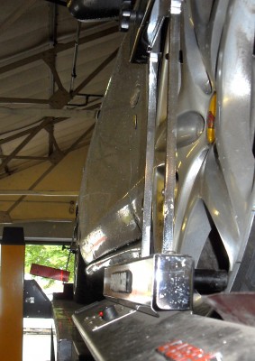

Centre to centre measurement with tie rods and similar units is never easy and invariably inaccuracies occur. In addition, measurements on the old rods may not have been correct. Someone may have previously messed with the car.
Only when a car goes up on the ramp and decent four wheel alignment equipment is strapped to the wheels, can true geometry be obtained.
Images here of my old hack, J44 being given the full tracking check. Rear wheel alignment equipment had to be cable tied to the rims as the car is lowered and the tops of the alignment gear had to be removed to get the gubbins under the rear wheel arches. A few minor tweaks later having ensured that all suspension bushes and bearings were still serviceable, the car was adjusted. thereafter, just for once it drove in a straight line.
Glad you got it sorted.
