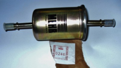

Fuel filter part number is FF318, made by MEHR. Cost is around £4.60 including post from suppliers on eBay.

This little fellow arrived today. £1.71 inc post from eBay. Sent by recorded post which cost the seller £2.46!
Perhaps sellers should not bother to put cheap items on eBay. This cost the seller more than the auction finish figure. Again, I`d have been more generous but no one bid against me!
