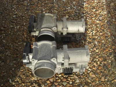

I wrote an in depth article on the throttle body in the S-type pages which appeared in our May 2010 magazine. Essentially it is the same unit for V6 and V8 cars but the V6 unit has an anti frost flow pipe let into the body.

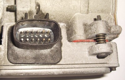

My car persistently went into limp home mode. Clumsy handling by the previous owner had broken a connection between the big black socket on the throttle body and the TAC Throttle Actuator Control module within the unit. No repair was possible. A ne unit is available from Jaguar for a very reasonable £1300 or remanufactured complete from BBA Reman at Rochester for around £500.

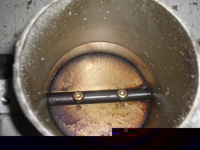

A sludged throttle throat and plate can cause issues. The plate is designed to snap to the shut position. A broken or weak spring or a throat and plate that are filth may inhibit that action and cause false signals to be transmitted to the control module. Clean out the throat first before trying anything else. A clean throttle also helps idle speed reliability. The sludge is from the part load engine crank case breather pipe which is fed into the inlet tract trunking. Clean the throat out once a year to prevent these and other peripheral issues.
Also try disconnecting the big black plug from the throttle a few times. Corrosion in that plug may cause the ecu to think that there has been a sensor failure. Sometimes that action is enough to restore full service.
I was fortunate to win an auction on ebay for a second hand unit for £20 including postage which came to me as in working condition. All I had to do was unbolt the old unit from the car, source a new gasket from jaguar which I now know is possible to make oneself and clean out the throttle throat and throttle plate with some rag and carburetor cleaner. That done, I cleared the MIL check light on the dash by disconnecting the battery for twenty minutes. I turned the key and the car started. I`ve done nothing more to that throttle body now, other than clean out the throat once a year. Reprogramming the car after a throttle body change is not necessary.

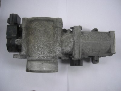

Before buying second hand, I would recommend finding your original part number from a defective unit. Annoyingly this is on the base of the unit and you can only get to that by taking the throttle off the car. It is essential to buy a replacement unit with exactly the same part number identification.
These throttles are built as one unit. Only the throttle position sensor mounted at the other end from the stepper drive motor can be replaced. The drive motor and TAC module are built and programmed to work together. It is not possible to swap out either of those two parts to repair. damage or defects to either the motor or TAC module means the unit is a scrapper. The only part that can be used again is the position sensor. That is not available as a spare part from Jaguar.

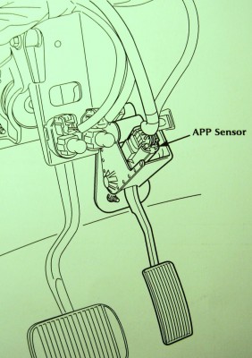

The throttle is one item that can have issues. The other unit often at fault is the throttle pedal which as Brian says can fail. One thing to check with the pedal is that the potentiometer on it is not damp. Sometimes removal of the pedal and overnight cooking on top of a boiler can cure an issue.
