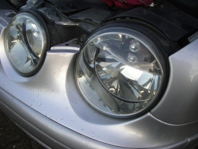

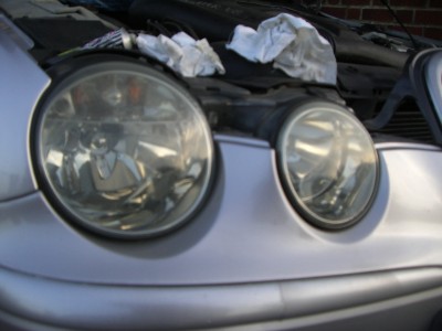

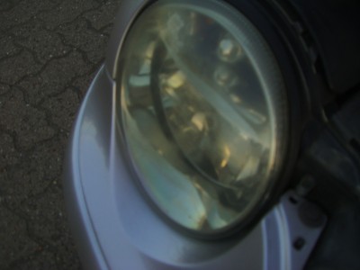

Last year I noticed how yellow and tarnished the headlight perspexs had become on J44. I put this down to ten years in the open, a high power headlamp bulb conversion, chemicals used at the local car wash, neglect and airborne contamination.
Recently I noted how dowdy J44 looked alongside cleaner better kept Jaguars. A project indeed for our Great Uncle Joe Turner to get his false teeth and ferret stuck into. I`m not a spit and polish merchant and my car is used as a hard worked extension of the contents of my tool box. That said, the car does receive the occasional birthday.
I looked at the propitiatory headlamp referb kits on the net. Most are priced around £20 and include a drill driven pad and several sheets of abrasive P400, P800. P1200 and an amazing P3000 grit papers and super-dooper polish and UV protector.
When I was a boy, I worked in a model maker contractors churning out presentation models of the Harrier for Hawker Sidley. My job was cockpit canopy polishing. I learned to file and fettle to perfection. The final buff up was with McCleans toothpaste!
So one half sheet of P2300 wet and dry paper, a bucket of soapy water, some Lidl paint rubbing compound and some toothpaste, we have a result. Judge for yourself the end result.

In the cold light of day, the off side lens are not quite as good as the near side units.
The rubbing down is somewhat arduous. Certainly just using P1200 does make the job a little long winded. Probably starting with P800 before progressing to P1200 would speed up the process. I stuck with 1200 as I was somewhat concerned that I might flat off too much material (correction to original post, polycarbonate rather than perspex) and alter light transmission properties and suffer an MOT failure for wonky pattern lights at a later date.
Given what I have learned, polycarb is a tough old material to work with when it comes to buffing up. The results obtained are in direct proportion to effort expended. I have a duff right shoulder and I have felt the pain today. So I suppose the secret id to do the job in a couple of spaced sessions or use a drill driven kit which would get results rather faster.
So I need to revisit the off side headlights again for a further five minute rub up session on each lens.
The car looks much better now and illumination appears just a tad better. More likely to be my imagination!

I did one side of my S-Type today. I started with 1200 grit wet N dry before moving to 1500 grit. The final buffing with Renovo Plastic Window Restorer. It is a great transformation, which hopefully I can complete tomorrow.
Thanks to Mike for supplying the inspiration for this.

OK, I completed the other side too and have before,during and after photos.
I'm pleased with the transformation, although I can see they are still not 100%, but an aweful lot better than before.
