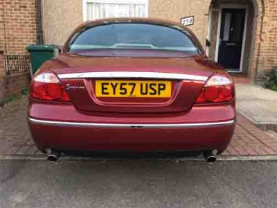

Hello all. After swapping my 2003 s type petrol for a 2007 Diesel, I noticed there is no 2.7D badge on the rear. Even after trawling the net for pictures I am unsure whether it had been removed by the previous owner, or they were never put on from factory. Has anyone any ideas if I should put one on not?

From memory my previous S type diesel did not have one either.

Hello Andy. Thanks for the reply. I am still unsure if it would look any good, some Jaguar brochures have some in but it looks bad with the exhausts that are 'turned down'.

The 2.7 diesel did not have the badge and the models that have the exhaust tail pipes pointing down have not got the dreaded DPF filter.
If you only do short journey work keep your eye on the engine oil level if it starts to increase change it. Also I would give it a 20 mile run up and down the motorway once a week to clear the DPF filter.
