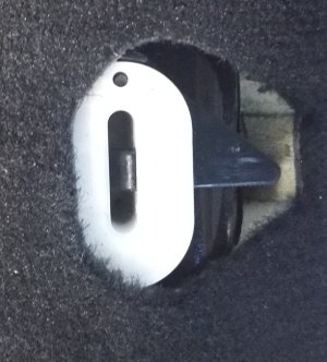

Removing the rear seats was actually quite easy. I was impressed with how well attached they were, but also the ease with which they could be removed. My main comparison was with a 1990 Fiesta RS Turbo that I stripped to a body shell for use in a kit car. My favourite parts were the clips that hold the front edge of the rear seats. Simple and effective.
Rear seat mounting clip

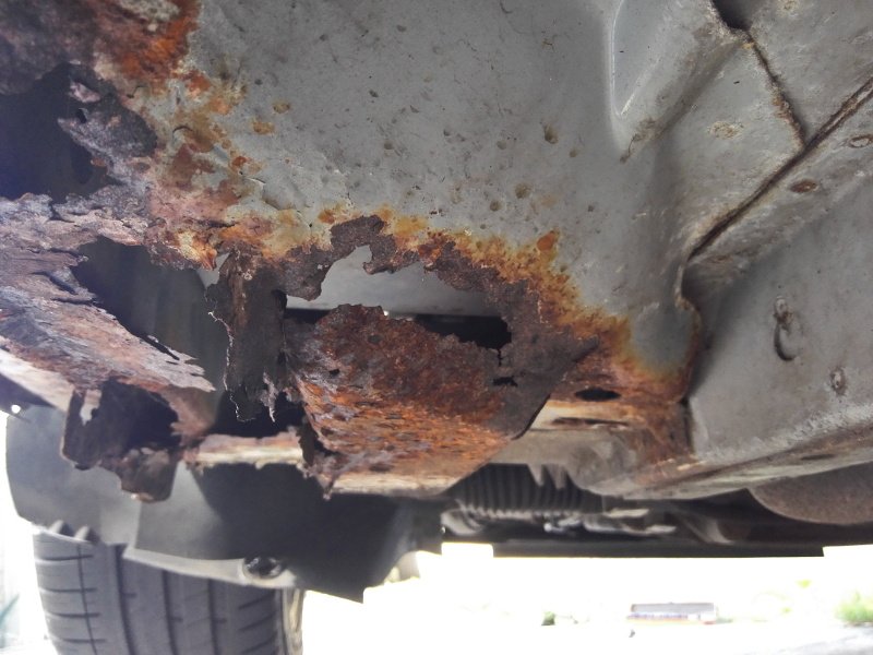

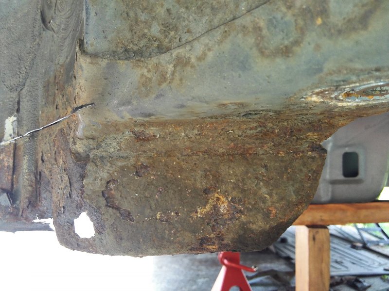

A few more images to show the extent of the rust under the car.
This was the front nearside just behind the wheel. While this is not a jacking point in original condition it might have been possible to jack and/or support the car here. As you can see this wouldn't have been possible on my car.
This is after cutting out some of the rusted metal away from the outer part of the sill and also part of the inner sill.
This is taken from directly below where the nearside front wing bolts to the chassis. The wing looks to be OK at the point, but the area around it will need attention.

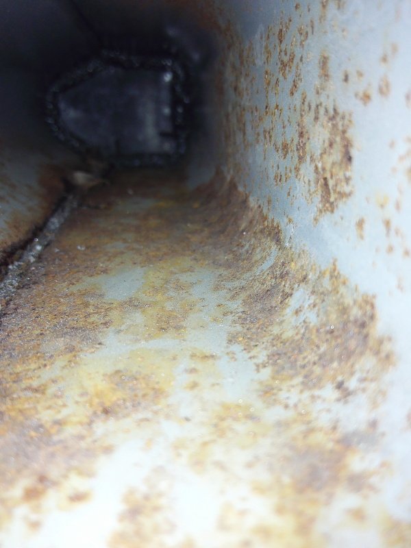

To help work out how much rust was hidden I took this photo inside the sill looking towards the back. As you can see the join area at the bottom is very rusty, but there is mostly surface rust elsewhere.

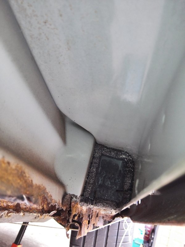

After cutting more away working towards the back I came across this piece of plastic bonded in place with a foam like grommet - any idea why?

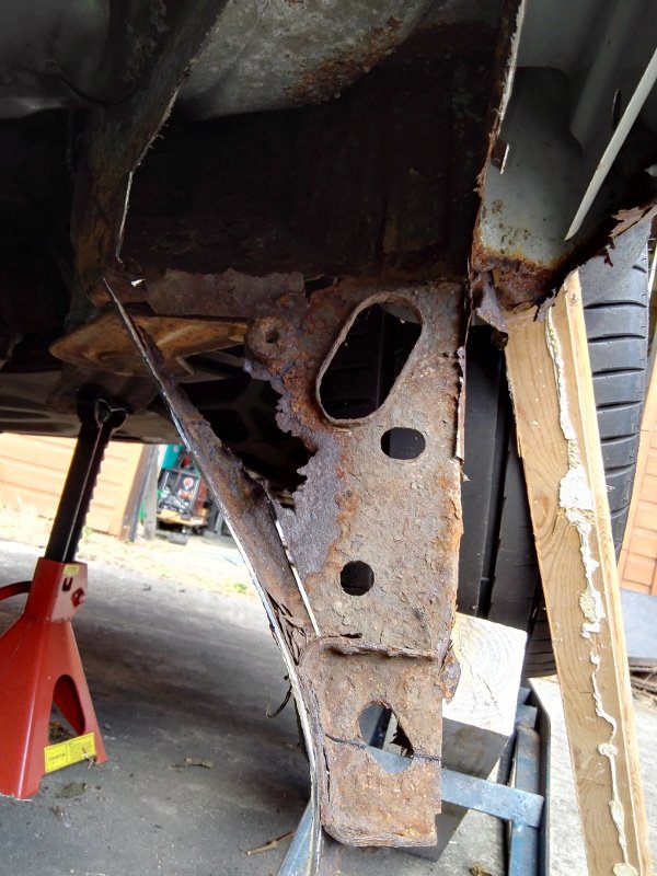

It got to the stage where I decided the rear axle needed to come off to improve my access. Having already removed the fuel tank, exhaust and prop this was an easy job. Disconnect the brake hose and electrical connector for each wheel then undo the 4 long bolts and slowly lower the whole axle. Before you lower it too much disconnect the electrics that are above the axle near to the electric hand brake motor, then lower to the ground. I had the car high enough I could wheel the axle out from under the car.
In this photo you can see the front mounting point for the axle at the far right. Thankfully this is solid, but the area to the left is where a bracket mounts between the axle and chassis. The 2 bolts at the chassis end were only connected to rust!

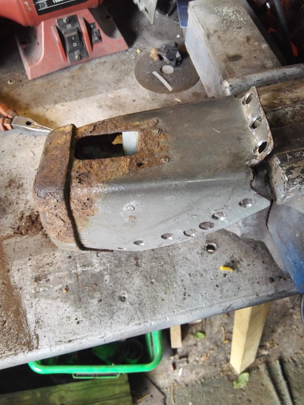

The front axle mounting point needed to come off. I carefully drilled out the spot welds and after a bit of extra cutting with the angle grinder I got this small section of chassis off the car. The photo below possibly makes the rust here look worse than it really is, but at least I now had good access to the hidden a parts and could remove the rust and protect it before putting back onto the car.
