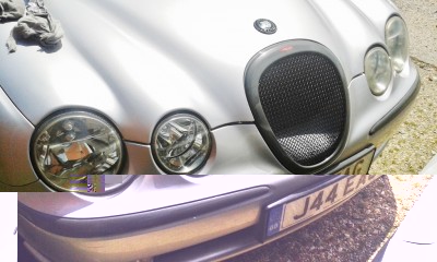

Anyway, here are the latest pictures with the first one showing the clear visual difference with the OS lamps having been manually polished up and with the NS lamps being in a pre-cleaned condition. The visual difference is easy to see. Cleaning up the lenses takes years off the car visually. xxxxxx Just tried to attach images but the message "Sorry, the board quota has been reached" has come up.". This has occurred in the past and James managed to sort the issue. James now informed and looking into rectification. Pics to follow then.xxxxx

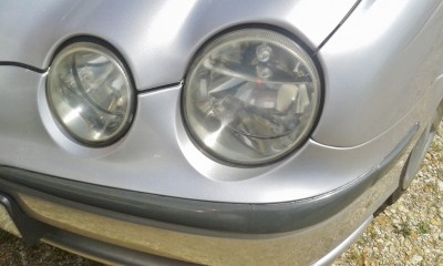

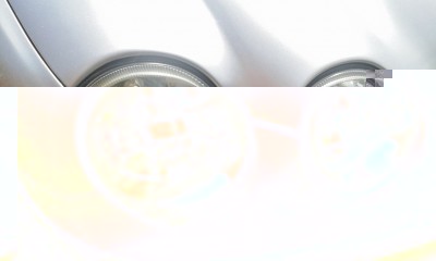

Images here now resized to "medium" in order to load up. 1024 max in this case.
Note the distinct yellowing of the lenses prior to a good polish up.
