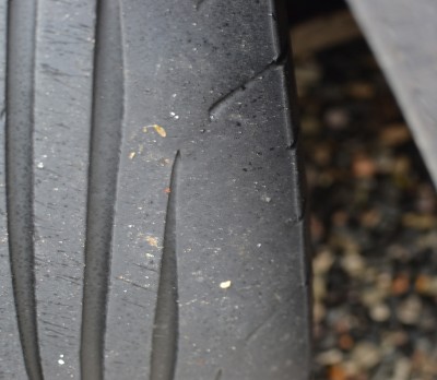

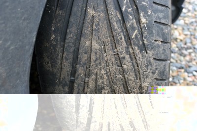

Thanks for that Mike. I've taken some photos so please let me know what you think. Cheers, Andrew
Offside scrubbing
Offside scrubbing showing 'lip'
Nearside
AGS
2002 STR 4.2

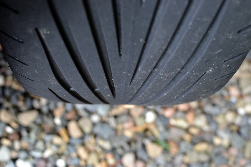

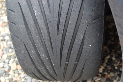

Postby AGS » Fri Mar 06, 2015 11:48 am
Here's a couple more :D
Nearside showing concave profile
Offside
