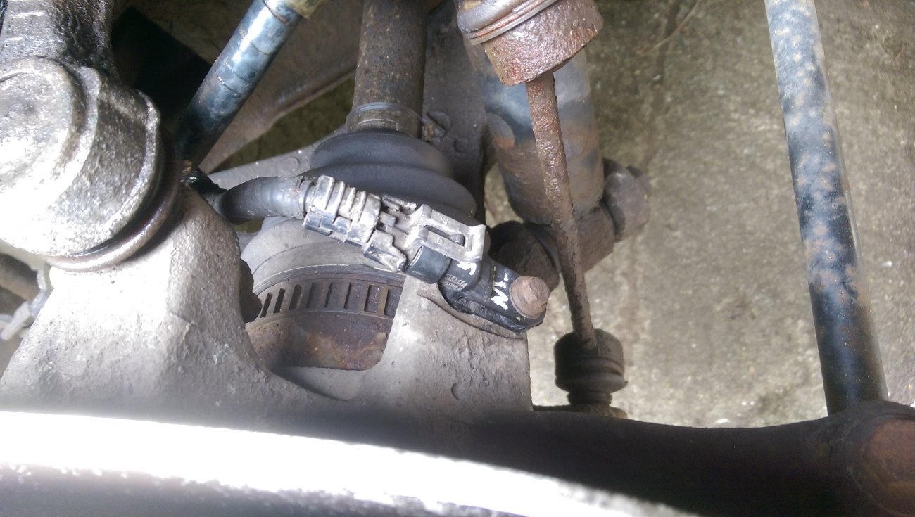

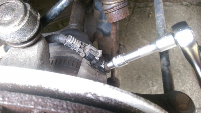

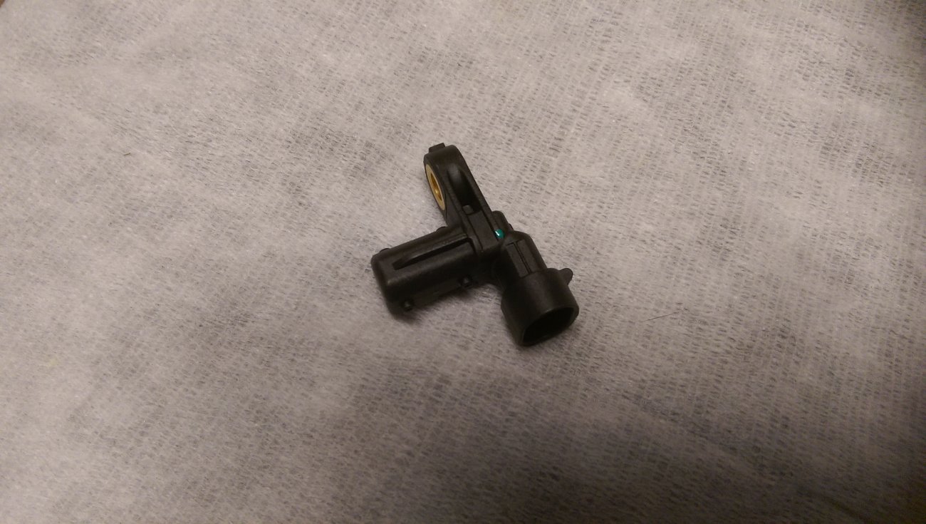

Had the ABS Fault light on and also DSC light, OBD2 identified offside rear. Rear ABS sensor part number XR822753, OEM Jaguar part £120.70. Ordered one off eBay for £19.99 https://www.ebay.co.uk/itm/JAGUAR-S-TYP ... 2749.l2649
Sensor is located just behind the rear disc above the hub, held in place by an 8mm bolt, remove the bolt, pull the sensor out of the locating hole and unplug, plug the new unit in, relocate back in the hole and fasten with the bolt. The lights didn't go straight out on start up but after a short drive one by one they went out.
