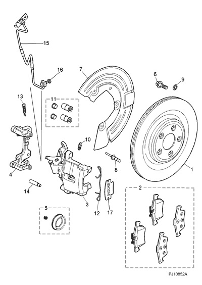

Just been doing some maintenance on my 2004 S-Type and found the flexi pipes, from the rear body to the rear calipers (both sides) were very badly corroded. The bigger shock was the price of a replacement one (or two in my case!) - over £50 per side, plus the dreaded VAT.
The pipe is item 15 in the exploded picture.

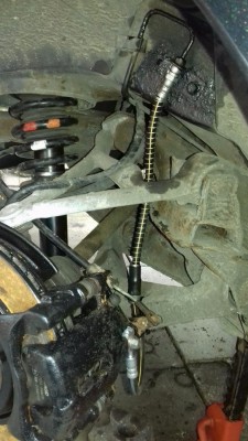

I discovered that a front flexi pipe from a 2004 VW Caddy had the right end connections and was long enough in length to do the same job - and they were only £10 each including VAT!
The only modification I had to make was cut through the threaded section of the mounting bracket, to re-use it to secure the Caddy flexi to the body. Obviously, you have to watch how you route it, so it doesn't catch any of the suspension whilst 'flexing'.
The job appears to have been successful - been using the car all week and no problems whatsoever.
