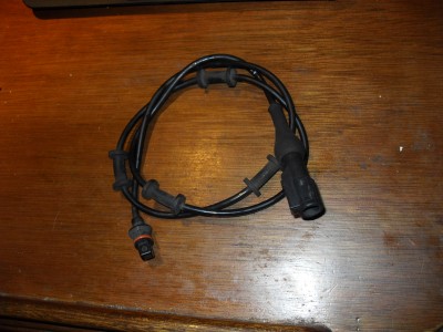

Found a pic of the sensor lead. Still can`t find the lead itself which has gone walk about!
Right, found it. The lead has two bright metal male prong connectors in the large round plug end. . The lead would appear to have a light two wire central core but the other end of the lead is perhaps best described as a hall effect type sensor which plugs into the ABS/wheel bearing cartridge . The lead is exactly one metre in length with four long rubber grommets used to secure the lead to suspension and body components.
The lead is marked FOVB-14A459 on the round plug end and 1404 on the cable. Sorry, no Jag reference number at this time.
