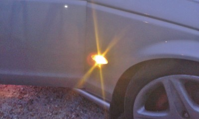

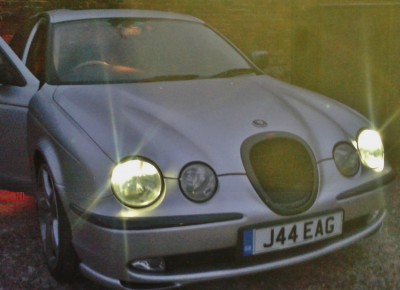

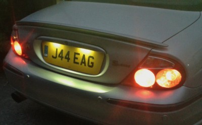

The same W5W lamps are fitted to the sidelights, the number plate and the front wing side repeater indicators although orange repeater LED lamps should be fitted in that location as fitting white units behind the orange plastic repeaters tend to flash rather yellow instead of orange. A few pic here.
