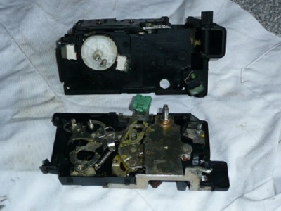

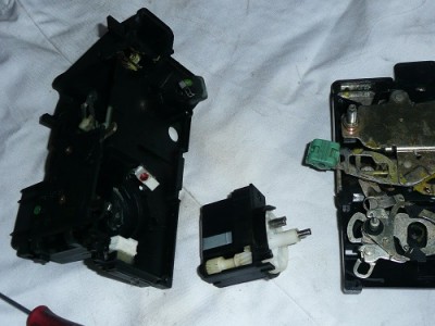

I've hopefully attached 3 pictures of the lock to show its guts, the middle micro switch is the duff one.
Brian

Sorry the pictures are not clear enough to appreciate how small these micro switches are, 15.3mm long (my camera will not focus on the switch).
