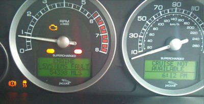

Multiple electrical failures have been the bain of my life for the last year.
It started off with a trip to Reading and the engine going into restricted performance mode with DSC, Park Brake and Cruise Control failure thrown in for good measure. A short stop, removing the ignition key and not re-inserting until all lights had been extinguished temporarily resolved the issue but the distance I could cover before it re-manifested itself got shorter and shorter and after the umpteenth time I was covering just a few hundred yards. I then admitted defeat and called the AA who cleared out the fault codes but it made no difference the car wasn't drivable. The vehicle was then lifted and taken to my main dealer who was somewhat uncertain as to what the fault was. A reflash of the software and all was well for approximately 2,000 miles when the problem reoccurred.
An ECU was thought to be the problem and was changed but 1,000 miles later the problem was back. The main dealer investigated and suggested that the wiring was probably at fault and that a new wiring loom may be required at a cost of around £600 with a further £2,400 for fitting but could not give me an assurance that it would cure the problem.
