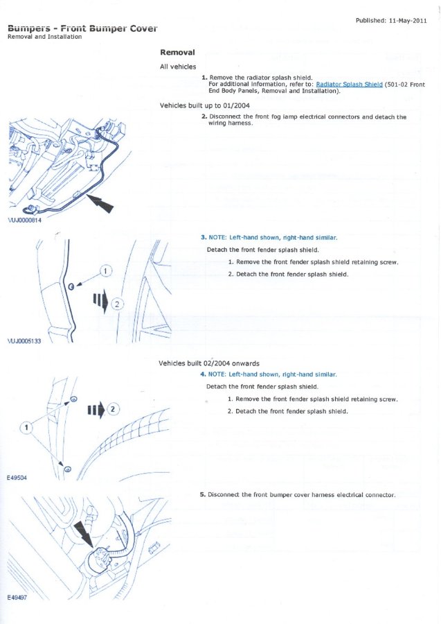

I have come across an issue however and that is the lamp replacement. How on earth do you get to the back of the lamp housing to change the lamps for new ones? It looks as though the bumper needs to come off to get the housing out for the exchange...
Thanks in advance for any advice or words of wisdom!
George.
HID Headlamp replacement
Re: HID Headlamp replacement

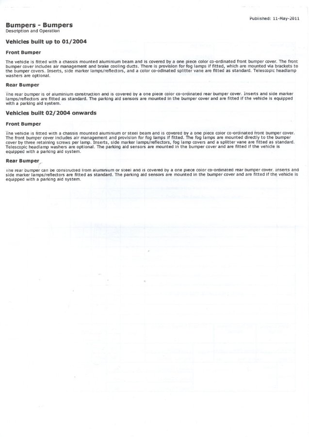

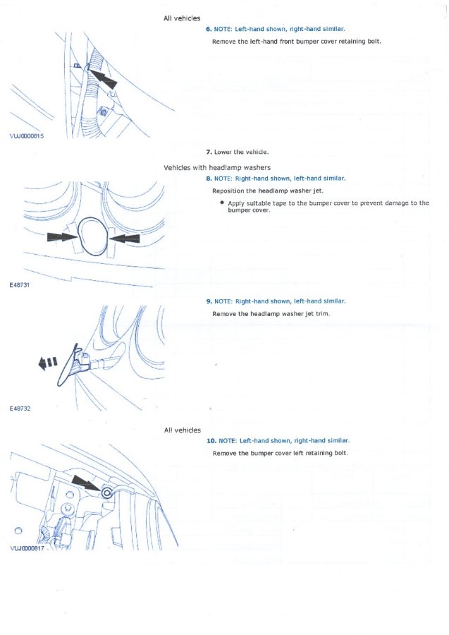

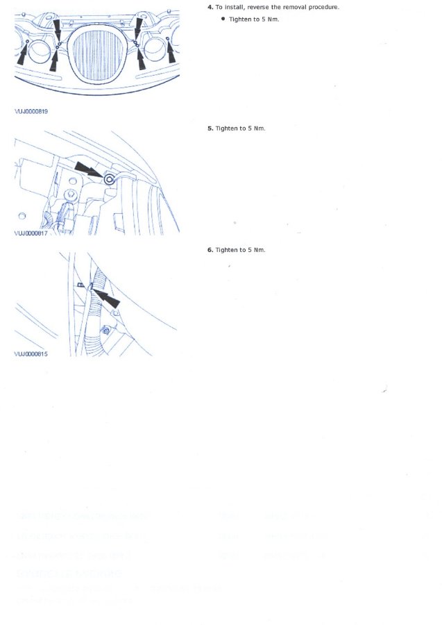

Hi George,
You are quite correct when you assume the bumper has to be removed.
Here are the pages that refer to the procedure taken from the workshop manual. Continued on next post

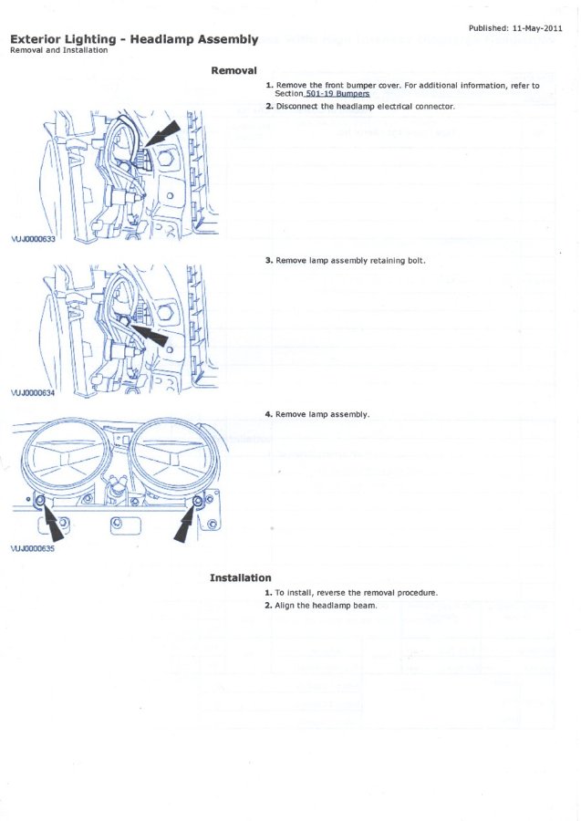

That covers the bumper.
In the next post will the headlight removal.
