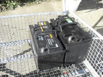

Further to writing the above post last year, an incident occurred just before Christmas 2011.
I managed to lock myself out of the car and had to smash the drivers door glass to gain entry. Details in the January 2012 magazine.
I had to leave the drivers door stripped down for a few days and left the door lock module disconnected. Unbeknown to me, this left the interior lights on which drained the battery. This type of abuse does a battery no good at all, and in this case I knew this battery would have a shorter than usual life span. How true those words turned out to be. Having not used the car very much over the last few weeks, regular recharging was minimal and in the end the battery expired. Only two and a half years use on this unit. A short life indeed but that is how it sometimes pans out. No one to blame except myself.
When I had repaired the car, the battery refused to start the car. Terminal voltage was down to 7.5volts and I knew I might have a future problem even if the battery were to accept and hold a recharge. To my amazement, the battery responded and all has been ok apart from a few misfires and a car that felt a little tetchy to drive. I put that down to lack of use although I had considered that the car might be unhappy on the new set of AC Delco spark plugs I had recently installed.
A couple of weeks ago with temperatures down to -4 degrees C, I turned the key. Whilst the starter solenoid chattered, that was all. A jump start got the car going again. A few days later, I tried to unlock the car on the key fob. Nothing at all. There was so little power available that even the key lock failed to operate. Totally dead battery.
Fortunately, the boot key lock does not need power and the well oiled lock responded to the key and access to the battery gained. Note the key hole for the boot lock is below the letter U in Jaguar on the boot lid plinth. Not a lot of people know that. Keep that lock oiled. Thin machine oil works well. WD40 tends to loose its qualities after a while so I avoid using it in locks. Having removed the battery from the car, I clipped on my drop tester which showed a terminal voltage of only 6 volts. Definitely a dead battery. I applied the load unit to the battery and voltage fell to an unacceptable 1volt. Out of curiosity, I tried a quick recharge via mains charger which showed a whopping 16volt input on the drop tester. That dropped rapidly to 11volts - which was far to low to have the correct effect. Again I load tested and only 0.5volts was evident. At that point I gave up the fight. I stole a well maintained battery out of my boat which fitted the battery carrier in the car. Being a typical marine unit of 110ah capacity, it was 30mm taller than the standard 90ah battery it replaced. I had to re bend the lock down tie rod to suite the height and make a longer new negative lead as battery terminal positions were differently placed on the ex boat battery. Nice to have 20ah extra capacity. I always thought the standard battery size was right on its limit in cold weather. The car cranks and starts more quickly than before and having driven it around, the engine seems sweeter and more oily than before the replacement battery was fitted. Certainly the engine runs without misfires better at idle speed and is more even especially when the exhaust sound is listened to.
I believe there is a voltage related issue here. Whilst the alternator does supply recharge current to the battery, I am convinced that as low voltage can cause so many problems as described in earlier postings on this thread, I am similarly sure that a stable and sound battery "platform" is needed to ensure that spark plug feed and ignition module performance is dependent upon the need for a battery in prime condition. Anything less than good condition also leads to issues with the Power Control Module and its inability to perform when under 12 volts are available at the battery terminals.
All these little issues add up and make sense once a prime component is replaced. A decent battery is the heart and soul of an electronically managed car and it is worth remembering if your car suddenly acquires a string of irritating electrical glitches. At the end of the day a battery is a consumable item with a finite life span. Some batteries last well, others not so.
