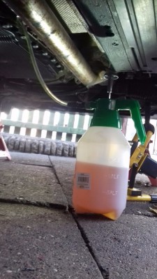

Re: Manual gearbox oil
Getting oil INTO the box?
Try this method I used on my 2.7D auto:
