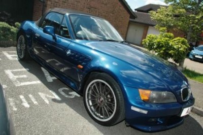

I think I am guilty of falling in love with my Jag and just want it to be the best it can be. However, as I am not a boy racer and I don't want to enter any competitive races, I think for now I will fit a K&N filter. I am not expecting any noticeable difference from what you say, but I don't know which type or how old the current one is, so £36 is a minimal outlay to at least ensure the car can breath properly.
All understood regarding the ECU. I also own a BMW Z3 2.8i straight six roadster with manual transmission, my "summer car" and it is in mint condition.
I had the ECU tweaked on this and I certainly made it more lively ! But this is a much lighter car so the extra grunt was noticeable.
I think circa £500 for a likely small improvement to the Jag is not a good investment ... if I want to go for a spirited drive, I have the below go-cart
Thank you once again for taking the trouble to give such a comprehensive and helpful reply.
