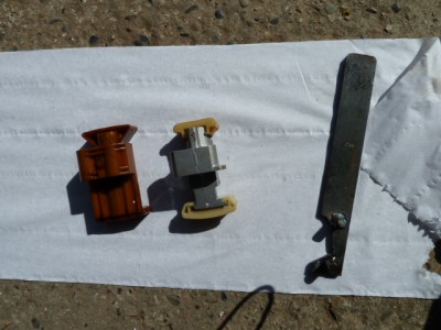

The guy replaced the tensioners on a V8 and he made the tools !!!!!
However, I lost them.... I will try to found them in the next weeks. I go to California on monday and to UK (in north of london) the week following. I will work on my S when I will be back.
This morning, I measured the camshaft to provide the plan of the tools. If I found some time, I will make adrawing and provide it to the BB.

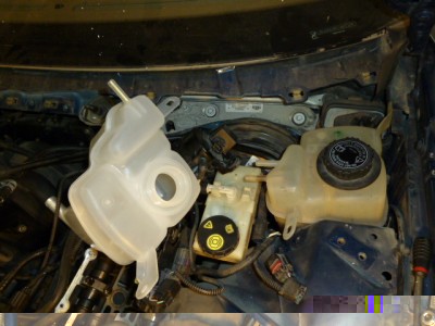

I received the spares in France from Nevile.
The new tensioners, the gaskets and the water expansion tank.
However, the tanks is not the corect one !
I assume that the UK tank is specific (LHR/RHD....) !!! I will not change the tank today ! I had an issue to remove the fuel tank pipe to remove the left rocket. Which one that is blocked with a green piec of metal. I tried many technics to remove the plactic tune from the matal tube ... I failed.

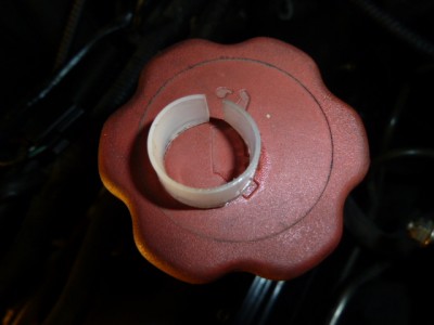

After many §%00àà*pàopn, I found THE solution take a look on the picture.
I measured the dimension of the tube and I cut a piece of tube in plastic with the same syze and I pushed..... It is so easy... The tube goes! ! ! ! I removed the to rocker, now I need to found the tool to block the camshaft!

There are two different models of header tank. One for left hand drive, one for right hand (UK) cars.

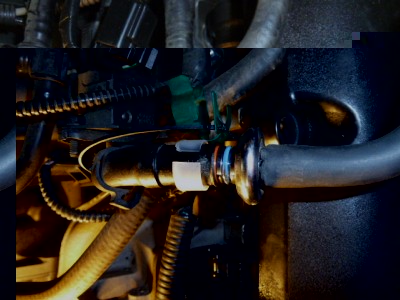

We discussed the fuel pipe problem on the telephone recently. This is difficult to separate without the special tool which is similar in concept to a domestic plumbing 15mm Hep2 O speedy fit unit. Richard, you have done well to make your special tool to separate the pipe unit. Well done my friend! Designed by the English, dismantled by the French!!
For those who have not come across this fitting, Richard as removed the green clip from the pipe unit. This has exposed blue and green lock rings which I assume when squeezed by the white home made special tool, allow the two parts of the pipe to be separated. This is one of those parts which can be difficult to work out how it comes to pieces!

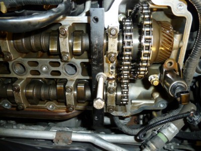

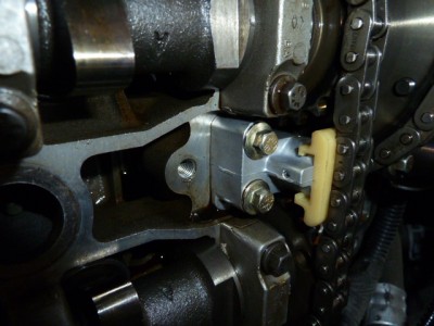

I foud some time to work on the S-Type.
I get a home made tool camshaft setting ref 303-530 tha I had to adjust, the hole didn't fit correcly. I made also the timming chain tensioning tool ref303-532 I removed my original tensioner. It is very good. No trace of crick.
I installed the new one. I was surprised by the difference of rigidity of the two tensioner. The old one is more hard than the new one.
I installed the new one, however, I don't like it, because the chain is not well tighted !!!!

Re: Timing chain tensioners
Hello Richard.
Perhaps Brake Buster can help with this problem?
I believe that the two new tensioners may be of different dimensions. Do you have the correct one fitted for the correct chain assembly?

on further inspection of your last picture, it looks to me like the tensioner is either upside down , or the worn one for that bank ?
but can't be sure
will look at my pics
BB
right , scrub the above ( my ) comment,
the tensioner looks to be installed correctly , so my thoughts are that its still in its ' pre-loaded ' locked position ,
the orange pin , if fitted needs removing to tension the chain , the pin is located on the sprung side of the tensioner , and is pushed in just under the radius of the slipper against the tensioner body
