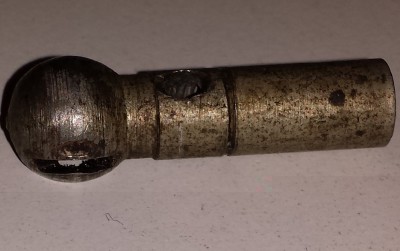

I'm looking for one of these shown in the attached photograph. Actually, I'm looking for the spring retention clip that fits on it. Its from the wiper motor link rod where it attaches to the centre wheelbox.
Jaguar parts manual calls it a Snaplock Joint with part number 8684. So far, I've spent months trying to find new but unable to track anything down.

I am looking to try and find a source for these. Can you measure the diameter of the Ball it fits onto and let me know? This will save me stripping mine down to have a look.

The diameter of the balls on the original windscreen wiper wheel boxes are 7.78mm or 0.306", whichever measuring system you prefer. I would guess that would count as a 5/16" ball joint. Threads are 1/4" UNF, if you didn't already know.
However, as usual, there is a difference between the original and the so-called reproduction parts, which have a ball diameter of 7.38mm, or 0.291".

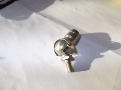

I now have two ball joints for the correct 7.82 mm (nominal 5/16") ball and machined to the correct 1/4" UNF connection thread. Thhese are £17.50 each, so please let me know if you are interested in these, otherwise I will put them for sale in the Jag Classifieds.

I bought the "female" part of the ball joint unit complete with spring clip today at the Jaguar Spares Day from RM&J Smith for £17.50.
They had a box full of them!!
