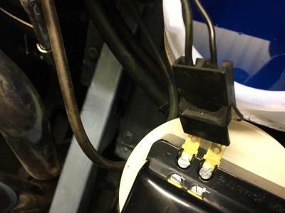

Hi guys,
I had to replace my washer bottle pump as the old one nearly caused an MOT failure. SNG Barratt have duly supplied a replacement which is an up to date version, with similar electrical connection, however, it won't pump any water out. I don't think there's anything wrong with the pump as it's the second one I've had, hence the puzzle.
As you should be able to see, the terminals on the pump are + on the right and - on the left. However the plug on the loom is green/black on the left and black on the right.......in a plug that can't be connected wrongly as there is an overlapping part to cover the terminals. To my mind, black has to be negative, and therefore green/black, positive. But the old pump has the same configuration and used to work (weakly).
So what to do?, force the spade connectors out of the loom plug and try them the other way round, or am I missing something so obvious that I'm going to make myself look really stupid?!.....I'll risk it!

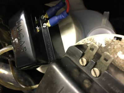

Thanks for your advice, the polarity was indeed reversed but not having ownership of a power probe I took a more basic approach and made up some short wires with the appropriate spade connectors, thereby swapping the connections from the plug and squirt it went....
I still don't understand why as if you look at this, the + and - on the pump are the same old and new:
However, it works so all's well etc. The new pump is much more efficient to the tune that the pipes leaked at the "T" piece so that had to be sorted too, and all for the MOT technician to check it once a year!!
